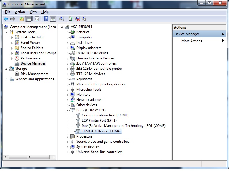

I have tried several times to install the Clock Pro Software.
Originally I could not even get the driver to load but resolved that and now it only shows
Ports (COM & LPT)->TUSB3410 Device (COM4).
I tried these instructions from another post

  • Below is a capture of Device Manager using a driver that appears to work.  The problem is that the board does not boot meaning that it is possible that the internal rom is not configured.
    I attempted to use the program that is supposed to write to the EEProm but to no avail as stated previously and it appears the drivers in the files for the EEProm Burner are not compatible with Windows 7.

  • Hello William,
    I think a solution for an early issue got mixed now into your driver problem when you tried to flash a new firmware into the EEPROM.
    We now have two separate issues here:
    1) Win7 driver load issue of the TUSB3410 Virtual Com Port because of the driver signature.
    2) TUSB3410 does not recognize the firmware in the EEPROM properly and falls back to a generic mode.
    We need to start rolling back by putting the a clean EEPROM and inserting the correct firmware.
    Prerequisites
    a) keep the bin file from the zip ready
    b) clean all old driver left overs: 1) uninstall any clock pro software or EEPROM which you still might have installed by using the respective uninstallers. 2) go to the hardware device manager; top menu-> view-> show hidden devices; select any "TUSB3410" and "TI CDC..." devices you might find under "USB devices" and under "COM ports"; when you delete them, please enable the delete files option. 3) reboot 4) crosscheck in device manager that there are no devices left.
    c) get a Win7 compatible EEPROM burner tool
    install it. Please ensure that you write the bin file as a full binary image and that the EEPROM size is 64k. When the firmware should be somehow broken, it may be necessary to use a metal pincer and short the SCL or SDA line at power up as the TUSB3410 will automatically try to load a firmware from the EEPROM. The EEPROM burner software does not verify the actual EEPROM content after a write.
    After the next power cycle of the EVM. It should already show up as a device lacking a driver but in the device details the correct USB VID, PID (0x451, 0x16E0) should be visible.
    d) After re-installing the scac119e (clockpro1v21.exe) the EVM should properly come up. In case it shows a driver signature issue (depends a little bit on your windows security rights setup). It may be necessary to install the driver with a manual "update driver by INF" process, so that a warning dialog can be clicked.
