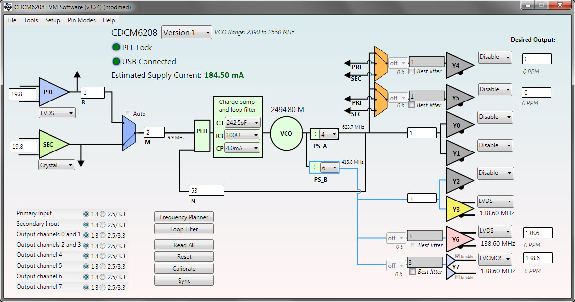

Hi Sir,.
there was reference design with  CDCM61001RHB + CDCLVC1102+ KC2520B25
but customer request would be  MGTREFCLK 138.6MHz around (2.772Gbps, 1.386Gbps),
and 609Mbps portion also 138.6MHz,
have your suggestion please for CDCM6208 or LMK04906 solution with complete , thanks
  • You can use CDCM6208 with 19.8 MHz XO or crystal input to generate 138.6 MHz.  This configuration can be programmed to the chip via I2C/SPI.
    https://e2e.ti.com/cfs-file/__key/communityserver-discussions-components-files/48/CDCM6208_5F00_Settings_5F00_138p6M.ini
    Alan
