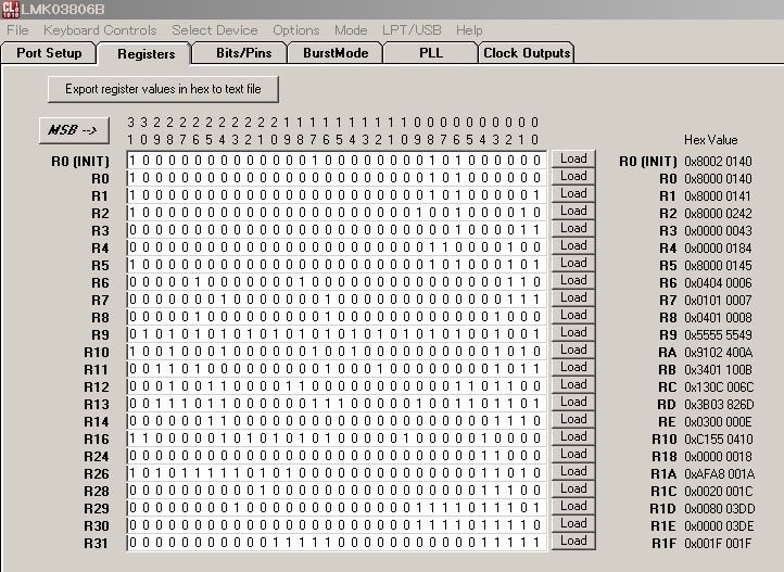

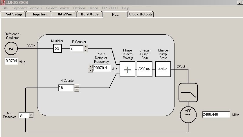

I have installed the new version (4.18.1) of Codeloader, and selected LMK03806B device.
When I tried to set the PLL register to x1 and R=1,  the Codeloader set the PLL register to x2 and R=2 automatically.
Why can I not set the register to X1 and R=1?
Also, I cannot set the register value directly on the REGISTER TAB.
