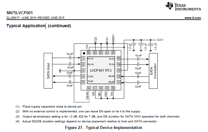

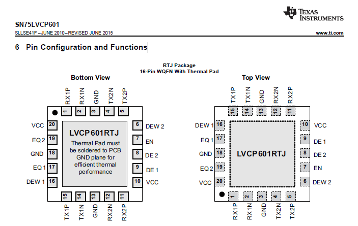

I downloaded the SN75LVCP601 datasheet from TI website, and have a question about pinout.
According to the datasheet,
at Page 4 (Pin Configuration and Functions) : DE1 is pin 9 / DE2 is pin 8 as below.
and at Page 20 (Typical Application) : DE1 is pin 8 / DE2 is pin 9 as below.
which one is right??
