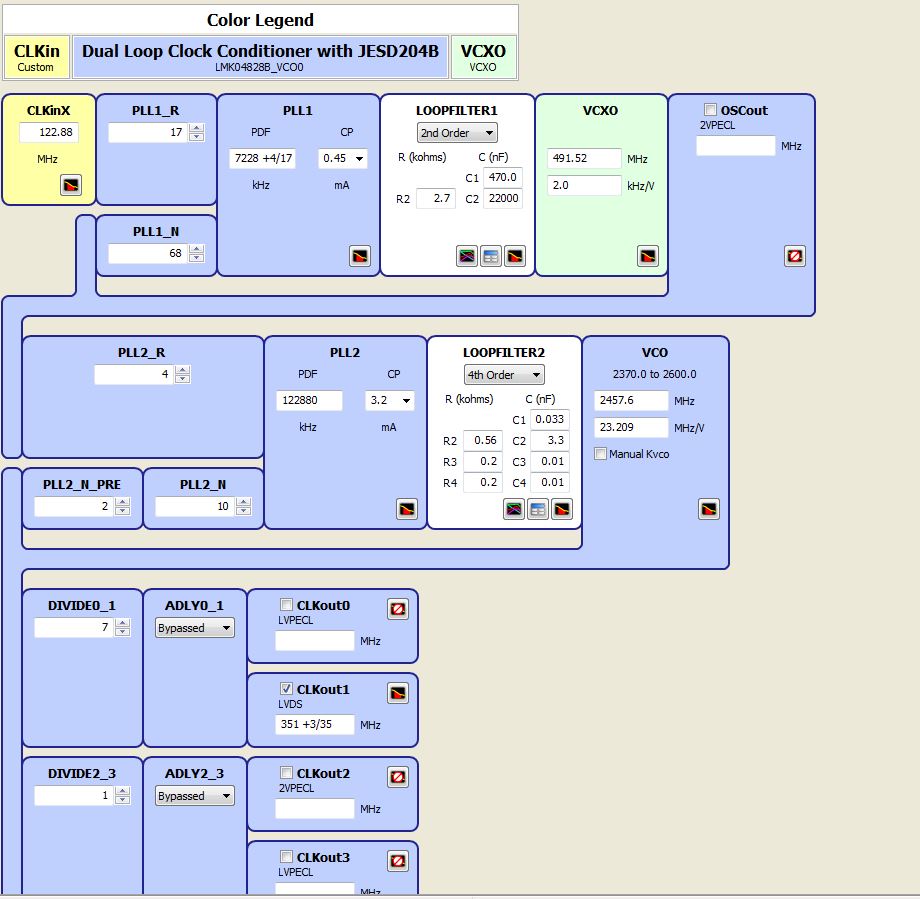

I am trying to use coadloader to load the spi interface of the LMK04828B device. I am also using the DAC3xJ8x gui v1,.1 software to confim. I have attached all my files where I simulated the clock to be ~351MHz, and how I have things hooked up. I have a 122.88MHz crystal input that generates the 351MHz output. The problem is SDCLK and DCLK should be the same and coadloader is not making them the same. Which divider did I miss or what am I doing wrong?

  • Are you measuring on CLKout0/CLKout1? They appear to be configured correctly. Several of the other clocks have SDCLKoutY powered down vs. a clock format selected.
    What are you measuring on the outputs such that they are not the same?
    Key things are the SDCLKout#_MUX = 0 (DC) and both output clocks are programmed for the desired output clock format.
    Side note, Since you are using /7, you may consider programming DCLKoutX_MUX = 1 (Divider + DCC + HS), this will result in 50% duty cylce.

    Thank you for the response. Yes, as of now we are only measuring one pair of clock outputs. I will measure again and verify. Thank you for the tip on 50% duty cycle.
