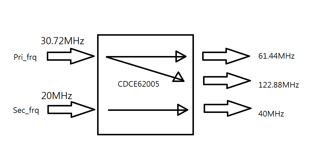

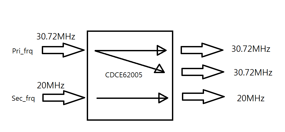

Two reference frequency components Pri_frq and Sec-frq are used and
Output 1, Output 2 are generated using Pri_frq and Output 3 is generated using Sec_frq.
Is it possible this way to generate multiple clock sources which are created by two independent references simultaneously?
More specifically, Pri_frq will be fixed as constant, on the other hand Sec_frq will be persistently changed. Output 1 and Output 2 will be fixed and
Output 3 which is generated based on Sec_frq, will be changed as Sec_frq is changed.
Does CDCE62005 have this function?
I am looking forward for your replies.
Thank you.
  • Hello Jang,
    CDCE62005 does have a single PLL only. With this architecture it is not possible to achieve the frequency plan.
    There are 2 options available:
    1. The newly released LMK03328 does have 2 PLL which can be configured to generate the requested frequencies.
    2. In case the 40MHz does not need to be phase locked to the 20MHz. a single PLL with fractional output divider could help. If the jitter/phase noise requirement on 40MHz is relaxed then the CDCM6208 could be an option.
    best regards,
    Julian
