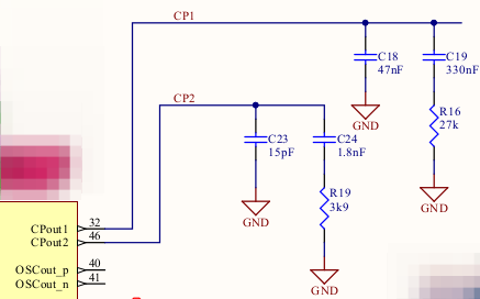

  • Hi Patrick,
    We designed our own PCB based on the ADS42JB49 EVM schematic.
    We are using an unipolar 10MHz ref clock connected to the CLKIN1 input.
    The VCXO is a CVHD-950-100.000
    The PLL2 is running at 2400MHz in order to generate only 200MHz LVDS outputs
    The passive loop filter is the following :
    We believe the PLL is properly locked, just some output which are missing.
    Here is the full config :

  • Hello gjoli,
    I checked the configuration.
    Can you please insert the following from our recommended sequence?
    W 00000165 48
    ### TI recommended sequence ###
    W 00000171 AA
    W 00000172 02
    W 00000173 00
    W 0000017C 15
    Apart from above recommendation, everything is configured alright. I also checked the PLL design. It looks ok so far.
    I would recommend to check if the input signal looks ok at the device pin. I'm unsure whether you can measure at OSCout when I look at your schematic.
    Please try to use the status pins to check whether the CLKin1 and the OSCin signals look to be stable at the PLL1 and PLL2.
    --> 0x0157 & 0x016E
    Patrick
