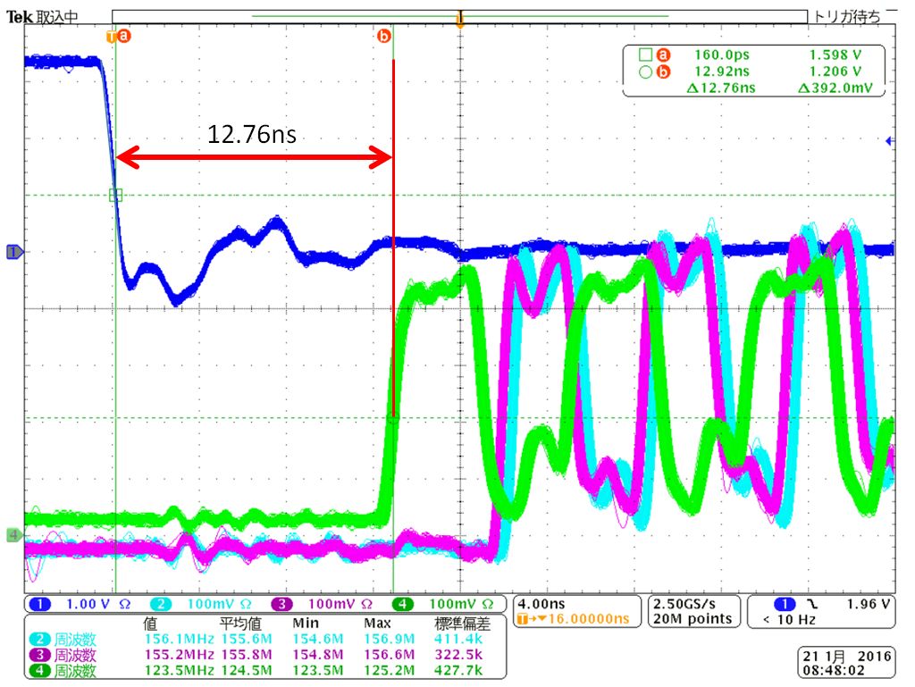

My customer has evaluated LMK04803, and  tried to adjust delay digitally by using SYNC signal.
The result was about 11.84ns against the expectation value, (VCO 1843.2MHz) x (6 + 5)=5.967ns
Could you please give me your advice for solving this?

  • Is the customer measuring from rising edge of LVCMOS to rising edge of output?
    Can you advise what the rise-time (20 to 80%) of the LVCMOS signal used for SYNC is?
    If you program another output to have a DDLY of 6 cycles, it results in 1 VCO cycle difference? 542.53 ps.
    The timing for the capture of the SYNC signal for the input is not defined.
    ->  No, from falling  edge of LVCMOS to rising edge of output because of SYNC_POL_INV = 0.
    -> The fall-time is about 600ps.
      ->  I will ask my customer to check it.
      -> Below is the captured waveform.
       CH1 (Blue) is SYNC at SYNC PIN and CH4 (Green) is OUTPUT at FPGA input, (not CLKout pin).
          The timing from SYNC pin to  CLKout pin is 11.84ns.
          The distance from CLKout pin to FPGA input is about 150mm.

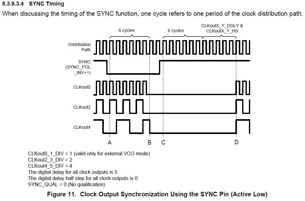

  • Hello Toshi-san,
    We investigated the today and found that there is an approximate 6 ns propagation delay from the SYNC pin to the SYNC trace seen in figure 11.  From the datasheet on page 33 is the comment about the SYNC pin being a CMOS input.
    Note: Due to the speed of the clock distribution path (as fast as ~325 ps period) and the slow slew rate of the
    SYNC, the exact VCO cycle at which the SYNC is asserted or unasserted by the SYNC is undefined. The timing
    diagrams show a sharp transition of the SYNC to clarify functionality.
    As such, over many devices, temperature, voltage, you may find a small variation of SYNC to clock start time of +/- 1(?) VCO cycle.
    Further, we observed that changing the amplitude of the SYNC signal/slew rate could vary the propagation time.
    If timing from a SYNC signal to output clock is critical, I suggest considering LMK0482x family which has the ability to use CLKin0 as a differential high speed SYNC signal to the dividers.

    You mentioned that there is an approximate 6 ns propagation delay from the SYNC pin to the SYNC trace seen in figure 11.
    Is the 6ns delay from Sync pin to SYNC trace an additional delay?
    Is the customer's result correct?
    Toshi
  • Hello Toshi-san,
    Yes, the customer's plot is correct.  The figure 11 is from the digital in the chip perspective.  As measured, before the SYNC signal arrives, there is some propagation delay from the gate.
    And also important is if precise timing is required from SYNC, it is not assured due to variation in that propagation delay and because it is re-clocked, a small analog shift in propagation delay could result in the output skipping an entire vco clock period (or clock distribution period, which is vco clock period after VCO divider, if VCO divider used).
