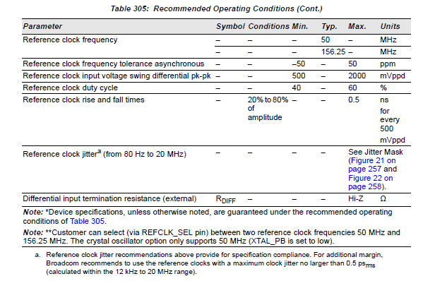

Hi , Experts. My customers called T&W electronics is designing the layout of the CDCLVP1204 part in the 5G PON. The challenge is the trace from the CDCLVP1204
to the receiver is about 5000mil in FR4 board and the impedance is around 100. The signal is the 156.25Mhz clock . So they concern the trace is too long for our
buffer driving. Could you please input your comments , thanks!
