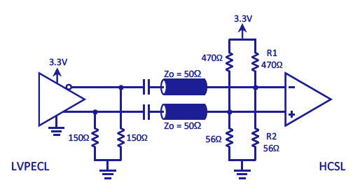

AM572x EVM used the CDCM9102RHBR for PCIe as LVDS clock.  My customer would like to use the HCSL clock type. So if change the clock device from LVDS to HCSL, how should we change the termination circuit?
