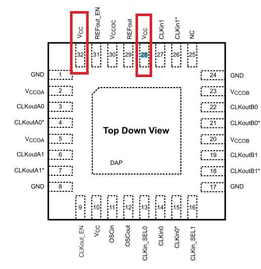

Hola,
I have two questions about LMK00334 as below:
QUESTION-1:
CLKin0、CLKin1、XTAL input are selected by CLKin_SEL.
1) When select CLKLin0 as a input, CLKin0 = 100MHz and the CLKoutA0、CLKoutB0 = 100MHz?right?
2) When select CLKLin1 as a input, CLKin1 = 200MHz and the CLKoutA0、CLKoutB0 = 200MHz?right?
3) When select XTAL as a input, XTAL = 25MHz and the CLKoutA0、CLKoutB0 = 100MHz?right?
4) About CLKoutA0*, what does * mean?......a negative differential signal?
QUESTION-2:
Pin28 & 32 has no description in pin function table, is it correct for these two pin define?

  • Here are the answers:
    >> You're correct.
    >> You're correct.
    >> No, all CLKout's will be 25 MHz (same as XTAL frequency).
    >> You're correct. It's the inverted or complementary output of the differential pair.
    >> Yes, these are Vcc pins and showed be powered with 3.3V +/-5%.
