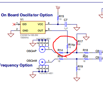

    1) Can you show me the schematic where R14 & R14p is?
    I based on Fig32 on datasheet (which may be different from eval board) & I can only choose between on-board oscillator & OSCinP is R16 & R16p.

  • Hi Shaun,
    1) The schematic on the datasheet needs to be updated. For the updated schematic please refer to the LMX2592EVM User's guide. Figure 4-1.
    Check the attached image for the location of R14 &R14P.
    If you will not use the on board oscillator, you should also remove R15 to remove power from the oscillator.
    2) Go ahead and use a 50 ohm termination for the unused OSCin port.
