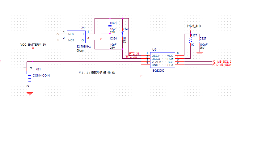

Hi team,
would you please help to review the schematic of BQ32002 from my customer Perabytes? they have tested the circuit but they found the 1-second register didn't refresh. BTW, they have pull up reisitor on I2C interface on MCU side.
Kevin
