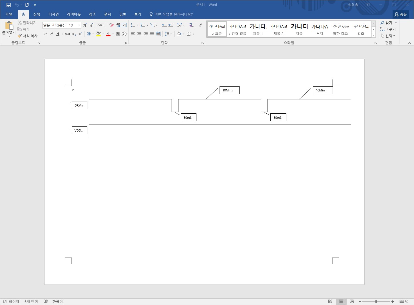

I want to generate periodic pulse signals for reducing power consumption.
So I am looking into the TPL5111 for this purpose.
Also, I want it to generate the signal by itself. I mean I don't want to use DONE pin.
Is it possible to use this IC with grounding DONE port?
Here's my final goal;
  • The answer by myself.
    It works well as I expected. I have tested with its EVM board.
    Without DONE signal, It generates the periodic DRVn.
    Only I need to complain is that I have confused due to the manual.
    There's a timing chart on Page9 Figure8 Where I can see Forced DRVn falling looking like sustaining at low-level continuously.
    I guess it should be 50mS pulse signal.
