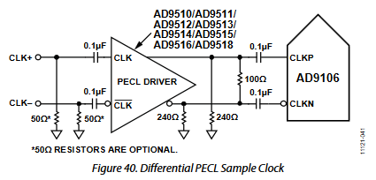

I have been trying to use the LMK61E2-125 clock source for driving a high speed DAC (AD9106).
Apparently, it should be a breeze getting the clock up and running, seeing as essentially only a stable supply voltage (3.3V), solid GND plane and a pull-up resistor for OE is needed. (Well, technically OE is supposed to have internal pull-up, but I added an external 10k resistor just to be sure).
Below the suggested driver configuration of the DAC is shown, using a PECL signal. I use the LMK61E2-125 as a substitute for the "AD9510/..."-driver.
I realize that the datasheet for the LMK suggests 150R resistors to GND, but the ~100R difference should not be detrimental to functionality, right?
So supposedly everything should be in working order - although not perfectly tuned. But when I turn on power, I only get ~1.5V DC on the output pins. (Yes, this is measured with a single-ended probe, as I currently haven't got access to fancy stuff like differential probes; I just need an indication of something actually working).
So I have tried removing the 100R resistor between the outputs - no luck.
Moving it past the DC-blocking caps - no luck.
I'm sorta running out of ideas, as there are not a whole lot of configuration options here....
Does anyone out there have an idea of what has gone wrong? Or seen this (lack of) behaviour before?
For good measure I should mention that the chip is handsoldered - I enlarged the PCB footprint to accommodate a soldering iron in order to mount the IC.
  • Did you check the current draw on the supply node of LMK61E2? For LVPECL, the typ current would be around 160mA.
    If you don't see any current, please measure the DC voltage at the VDD pad of LMK61E2 to ensure that at least 3.135V is present. If not, there is a loss somewhere on your power network. Likely due to higher DCR of any ferrite beads on the supply node.
    If these are ok, then we need to look at whether any issue happened from violating the recommended reflow profile. J-STD-020 must be followed and I am wondering whether hand-soldering caused violation of this spec. This will likely result in device malfunction. Can you use the profile as a guidance and try again?

    Yes, the current draw is very low, ~10mA in fact. Although it seems clear that the IC cannot run with any output at this current, it does seem to suggest that something is actually consuming power.
    On a related note the supply voltage is very close to 3.3V on the trace for the IC supply pin.

    For your rework on LMK61A2, it is LVDS outputs and so please remove the 150 ohm to GND on each P and N of output. When you power up, the current draw should be around 150mA. If this happens, you should be good.

    After trying to get a reflow oven to do my bidding, without success unfortunately, I did some rework on the PCB and made i extremely soldering friendly, at the cost of some GND plane. Taking all possible precautions I mounted a newly delivered IC (fixed frequency) on the board using a 'hot air gun' (whatever they are called) and a microscope to check my solderings. Although extremely time-consuming it, I was able to debug the circuit by your advice (current draw) and get everything up and running!
