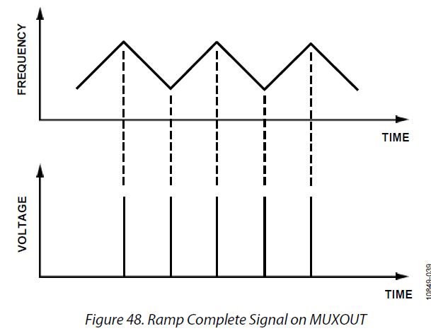

  • Hi Dean
    Thank you for your answer.
    But customer request is confirm of MUXOUT wave regularly.
    Sometimes is not regularly output wave of MUXOUT.
    Only showed 2 and 4 MUXOUT at rising time, but 1,3,5 is not showed.
    Please send me your comment.
    Eddy
  • Eddy,
    Here are a few ideas:
    1. Use the MUXout pin as "Output RAMP0 Active" and then you can use the rising edge for RAMP0 and the falling edge for RAMP1. Another choice is to use a separate pin for RAMP1
    2. If you want a narrow pulse then another choice is to actually make this with 4 RAMPS.
    Make:
    RAMP0_Length = 0.01 us
    RAMP0_FLAG = Flag 0
    RAMP0_NEXT = RAMP1
    RAMP1_LENGTH = 47.99 us
    RAMP1_FLAG = Disabled
    RAMP0_NEXT = RAMP2
    RAMP2_LENGTH = 0.01 us
    RAMP2_FLAG = FLAG0
    RAMP0_NEXT = RAMP3
    RAMP3_LENGTH = 47.99 us
    RAMP3_FLAG=Disabled
    RAMP0_NEXT = RAMP0
