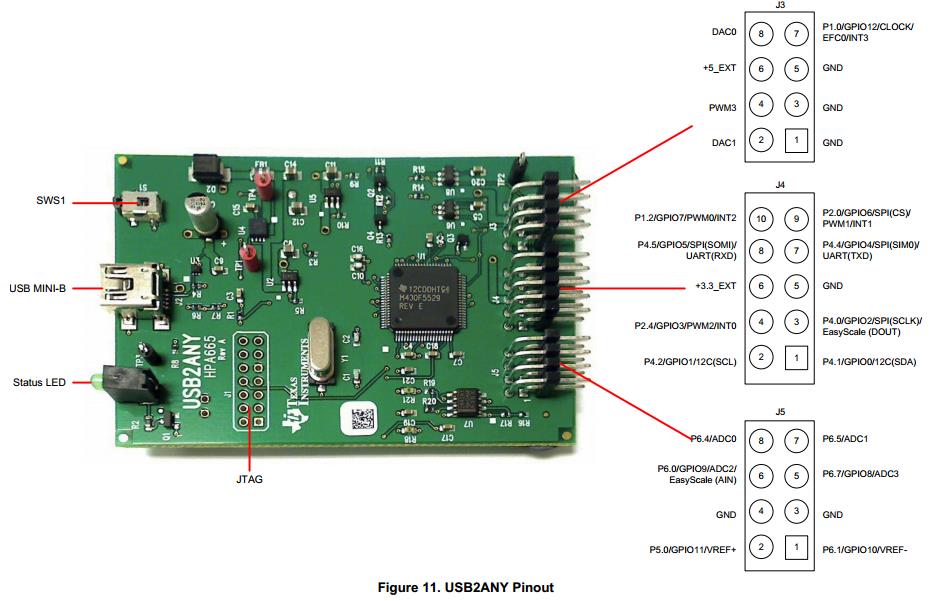

  • Hi Timothy,
    Thank you for your documents. I think the LMK chip might be damaged, and that might be the reason it doesn't output correct frequencies. So I decided to continue my experiments on the LMK04828 and LMX2581 from ADC12J4000EVM, since on this evaluation board it has the option to configure LMK and LMX externally via SPI. So my methodology was if I was able to configure LMK and LMX correctly using external SPI, I should get the exactly same output as using the ADC12J4000 software. So after trying with your suggestions, I encountered two problems:
    1. previously, I used a FTD4222H USB to SPI chip to configure my LMK and LMX using C++ to read my teand FTD libraries, however I noticed that sometimes clock outputs are half of what I expected, and the status 1, status2 don't light up as its supposed to unless I run the command program several times. It almost seems to me that my program doesn't write into the correct register or value with one try. So I wonder is there any timing specifications on how to program the registers other than it has to follow certain sequences?
    2. My second problem is that I decided to try to program my register using the codeloader, but it seems like the SPI connection isn't working as no matter how I change the parameters my chip doesn't respond. The PC to USB2ANY connection is working, since the light flashes when I click ' identify'. But other than that, no matter how I try to load device or run as default mode, there is nothing happening. So do you have a more detailed tutorial or something can guide me on how to configure LMX2581 and LMK04828, how to setup their pin configurations, and maybe what outcomes I could expect to indicate this SPI communication is actually working? The user guide didn't help me too much
    PS: the codeloader is version 4, the newest one that I downloaded from the website. Apparently on the user guide, it says the software might ask for an update for the firmware, but the windows never prompted out in my case. Does it mean that I have the up to date firmware for USB2ANY?
    Thank you very much
    Angela
  • I have found this diagram for the USB2ANY output pins. I just want to confirm since I'm using SPI write to LMK and LMX registers, so I should connect Pin3,5,7 and 9 of J4 to my LMK and LMX SCLK, MOSI, CS and GND right? I'm just confused how should I use the Pin configuration panel on the codeloader
  • You shouldn't have to change the port setup in CodeLoader. Make sure the pin configuration is as shown in evaluation board instructions. What is displayed is a diagram of the pins are configured. When using USB2ANY the Clock/Data/LE (LE is CS* also) are actually forced and don't respond to changes. The other GPIO can be changed however.
    Be aware that the USB2ANY documentation which shows pin 1. However in practice, when plugging a cable in, because of the way it is keyed is backward. Please refer to the pin out of the SPI Header from the eval board instructions vs. the above diagram when using keyed connector.
    The key items for connection are CLK, MOSI (Data), CS (LE), and GND. Also be sure that the RESET pin is not held high to allow programming. These are the basic requirements for communication/programming.
    73,
    Timothy

  • Hi Timothy,
    I'm not configuring the LMX2581EVM, I'm configuring the LMX2581 chip on ADC12J4000, so the pin configuration for those two LMX are completely different. And apparently CodeLoader's pin configuration by default is matching with the EVM board. For example:
    both EVM and LMX on ADC has a 10pin header which allows us to use SPI, however, on EVM, pin6 is GND, which matches with what's on CodeLoader, but the LMX2581 on ADC12J4000 has a GND at Pin9. Thus pretty much the pin configuration on CodeLoader is useless to me.
    My solution was to instead of using the 10pin ribbon, I made four wires that directly connect between USB2ANY and LMX on ADC12J4000 for SCLK, CS, MOSI and GND. However sometimes I could configure the LMX properly but sometimes not even with the same configuration. Could you tell me if my setup is correct?
    Thank you
