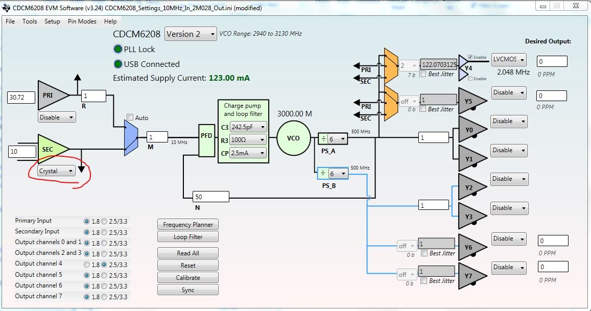

  • Hi Simon,
    CDCM6208_Settings_10MHz_In_2M028_Out.zip
    I input your registers into CDCM6208 EVM software, this software also could save your configuration as .ini document, as my attachment.
    The problem could be from 10MHz sine wave input. In your setting, it is Crystal mode.
    How about 10MHz sine wave amplitude? AC coupling or DC coupling? Is there DC bias with the sine wave?
    Could you show your schematic about this input circuit?
    Shawn

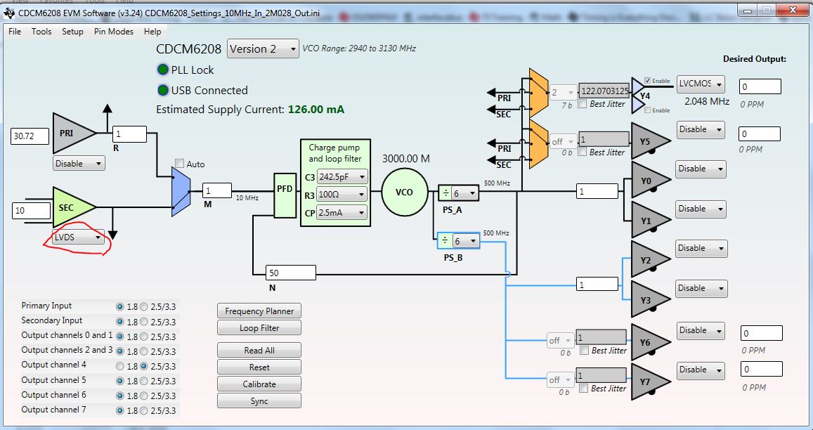

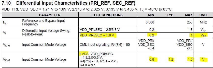

  • Hi Simon,
    We should change input type to LVDS in register setting. If the 10MHz source could drive 50 Ohm load, then below schematic could work. I also highlight input requirement from datasheet. .ini also is attached. Please refer.
    https://e2e.ti.com/cfs-file/__key/communityserver-discussions-components-files/48/CDCM6208_5F00_Settings_5F00_10MHz_5F00_In_5F00_LVDS_5F00_2M028_5F00_Out.ini
    Shawn

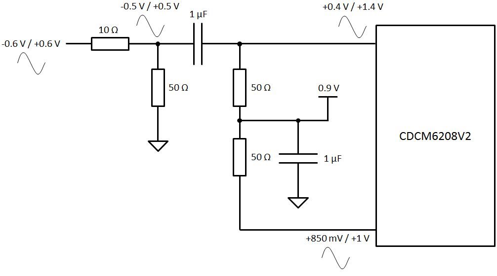

  • Hi Shawn,
    I got your idea and I tried something similar with what was available. I included a 1.2 Vpp to 1 Vpp conversion circuit with 10 Ω and 50 Ω resistors (I didn't understand the use of the 500 Ω resistor). I also connected SEC_REFN with R89. I put JMP11 on 0p9V. I changed R4[7:6] to LVDS mode.
    Shouldn't this work as well? I don't understand why I have a sine wave on SEC_REFN. The PLL doesn't lock and I get 1.93 MHz in output.
    Thanks.
    Kind regards,
    Simon
  • Hi Simon,
    500 Ohm is to make PI resistors network (500, 10,45.3) equal to 50Ohm , looked from transmission line. How about R72, R73? They should be DNI. How about 0.9V waveform?
    Best Regards
    Shawn
