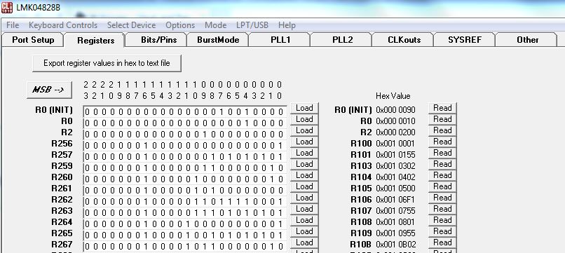

I am trying to configure LMK4828 using my own software.
I am trying to use the same configuration as detailed in LMK_Config_Onboard_983p04_MSPS.cfg file. I have pasted the configuration below.
But this configuration file does not seem to include the programming instructions as given section 9.5.1 in the datasheet.
Can you please tell me which steps are missing from the configuration file.

  • Hi Channamallesh,
    It seems LMK04828 setting in "LMK_Config_Onboard_983p04_MSPS.cfg" is not optimized. It is better to follow up steps as section 9.5.1 of LMK0482x datasheet, as below.
    "The recommended programming sequence from POR involves:
    1. Program register 0x000 with RESET = 1.
    2. Program registers in numeric order from 0x000 to 0x165. Ensure the following register is programmed as
    follows:
    – 0x145 = 127 (0x7F)
    3. Program register 0x171 to 0xAA and 0x172 to 0x02.
    4. If using LMK04821, program register 0x174.
    5. Program registers 0x17C and 0x17D as required by OPT_REG_1 and OPT_REG_2.
    6. Program registers 0x166 to 0x1FFF.
    When using LMK04821: Program register 0x174, bits 4:0 (VCO1_DIV) with proper value before programming
    PLL2_N register in 0x166, 0x167, and 0x168 for proper total PLL2_N value.
    Program register 0x171, 0x172, 0x17C (OPT_REG_1) and 0x17D (OPT_REG_2) before programming PLL2 in
    registers: 0x166, 0x167, and 0x168 to optimize PLL2_N and VCO1 phase noise performance over temperature."
    I could find some problems in .cfg.
    1, No RESET. It should be started with "0x00 0x90", then "0x00 0x10".
    2, "0x145 0x00" is not a good setting.It should be default 0x7F, Reg 0x171,0x172 also should be default value. It is a good choice to confirm these default value  before we continue to set other registers.
    3, "0x17D 0x0F" is not a good setting for LMK04828, as datasheet shows, we should set "0x17D 0x33". What's more, we should set 0x17C and 0x17D before 0x166, 0x167,0x168.
    For these basic clock setting sequence, you can refer to LMK04828 EVM software "Codeloader", which could export regiser values for your programming.
    For SYSREF generation steps, it is better to follow up "9.3.2.1.1 Setup of SYSREF Example".
    "0x140 0x00 //turn on all the blocks, can these just stay on?" -- You can trun off those unused blocks to save power consumption.
