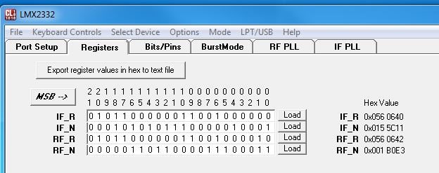

I believe I have found a bug in the CodeLoader tool. I am using it to program an LMX2332 device.
The programming works (using the USB adapter) but the Hex Values shown under the Registers Tab are not correct. The bit fields are shown correctly (and this is what is programmed to the device), but they do not match the Hex Value shown. See the attached image. For eg. The bit fields for the IF_R translate to a value of 0x00160640, while the tool shows a hex value of 0x00560640
I was trying to use the Hex Value to program the device using another programmer which showed the error.
Maybe this can be fixed in the next update of the tool?
