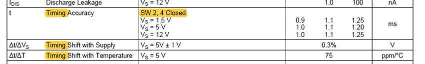

1.)
"6.5 Electrical Characteristics" shows "t: Timing Accuracy " .
Dose it mean timing interval accuracy like a following figure?
In addition, Do Δt/ΔVS and Δt/ΔT mean "Timing interval Shift with Supply" and "Timing Interval Shift with Temperature" ?

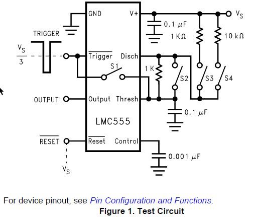

2.)
Test condition of " Timing Accuracy " includes "SW 2, 4 Closed" and it is based on following schematic.
Is "SW 2, 4 Closed" correct configuration for " Timing Accuracy " ?
If SW 1, 4 Closed, this configuration means like a Figure 6. Astable (Variable Duty Cycle Oscillator).
So I think correct test configuration of " Timing Accuracy " is " SW 1, 4 Closed ",
because /trigger can be set frequently with capacitor(charge/discharge).
