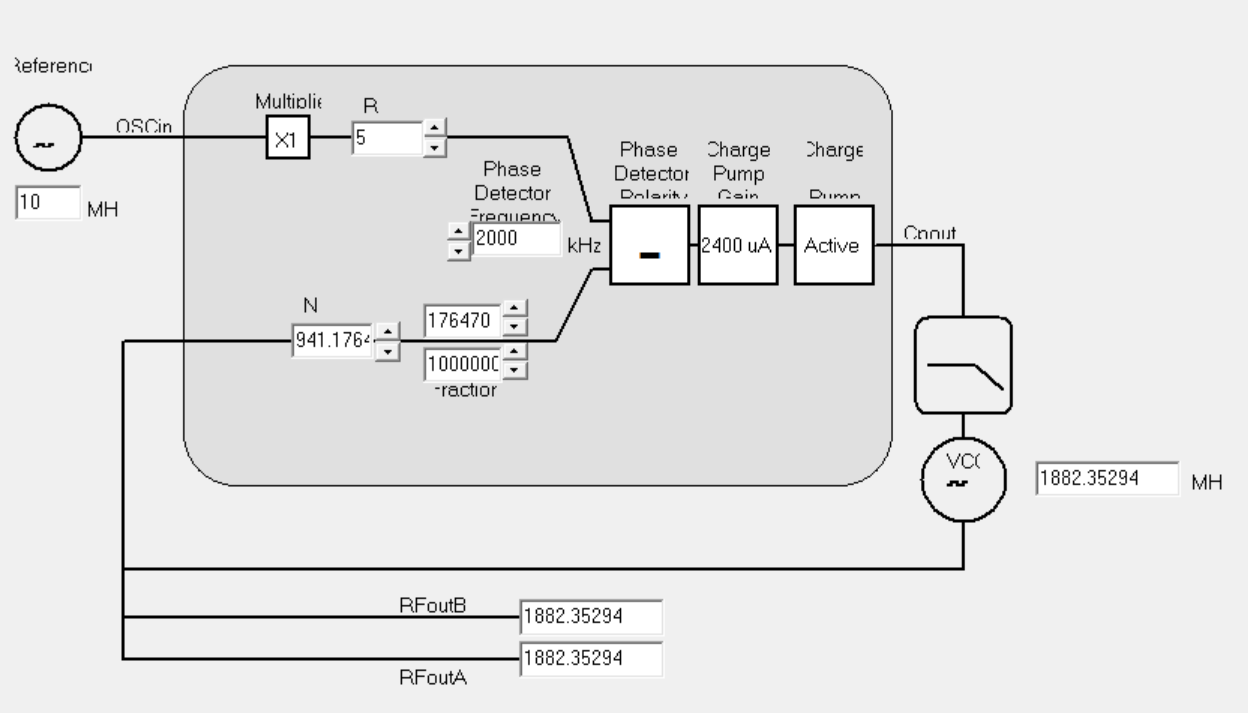

    First, my ultimate application is using 4 different clocks for four ADC cards to be applied for specific application. Before I do 4 different clocks, I tried 4 identical clocks with 4 sets of LMX2581E EVB to see if there is any phase jitters between them. So, that's why I need four sets of LMX2581E rather than using two pairs of differential outputs from one EVB.
    Second, I tried to use 0-delay mode but not clear what to do from the manual. Manual 8.3.10 says it is for when VCO divider is used, something I don't. Also step 5, it says new PLL_N is PLL_N*/VCO_DIV whrere PLL_N* is the original value. Would you please take a look screen snap shot and recommend what to do to create zero delay? FYI my output frequency is 1882.35294MHz

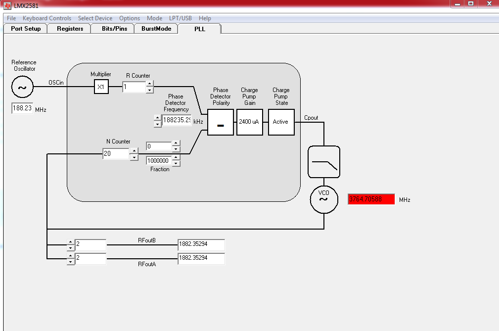

    thanks for your recommendation. I encountered several things.
    1. with 188.235294MHz reference, VCO is out or range if I use VCO_DIV=2. shown below figure.

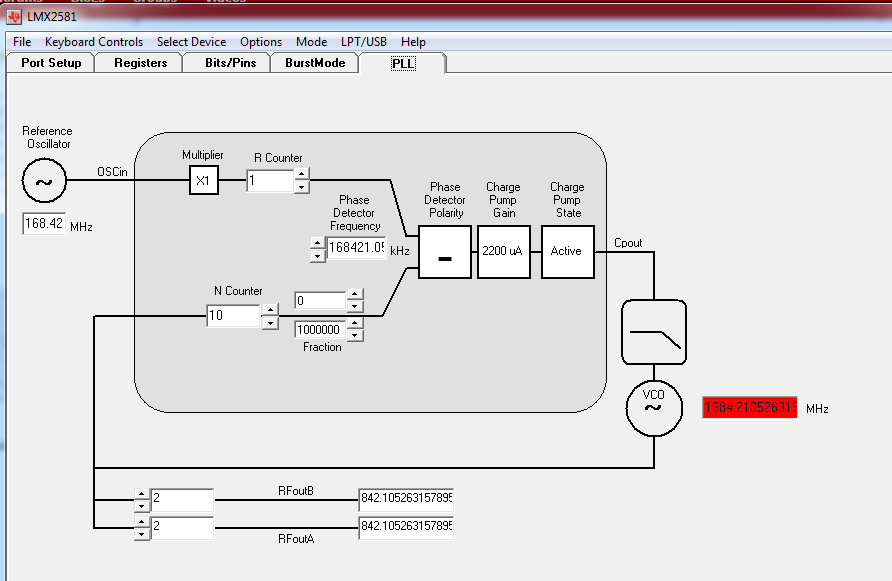

    2. So, to be used with VCO_DIV=2 with VCO range, I lowered down operating frequency to 1684.210526315789MHz
    For integer-N mode, I put 168.4210526315789MHz as a reference signal from signal generator with 10MHz external reference from Symmetricomm.

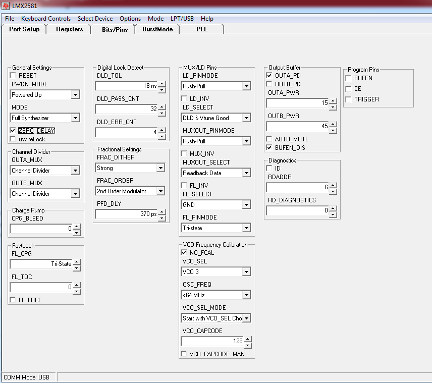

    3. Now, for 0-delay, I set up my "bits/pins" setup is as below.
    with all the steps up to step 5, with new N-counter to 10, I got following screen.
    Now frequency was halved.. I am not sure what went wrong on my setup. Please advice.
  • Hi Youngho,
    LMX2581E supports up to 3.8GHz, no worry. The tool is designed for LMX2581, so it will turn red if it is out of range.
    if you have hooked up the EVM, after step 5, you should see the phase alignment but the output frequency will remain unchanged.
