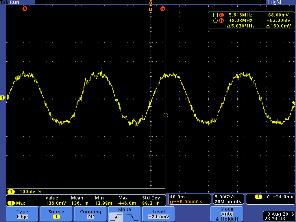

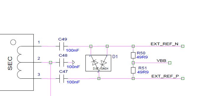

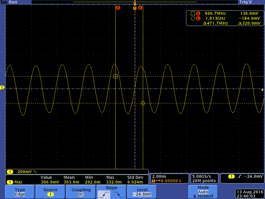

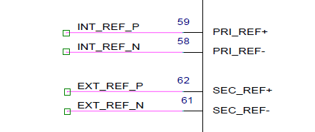

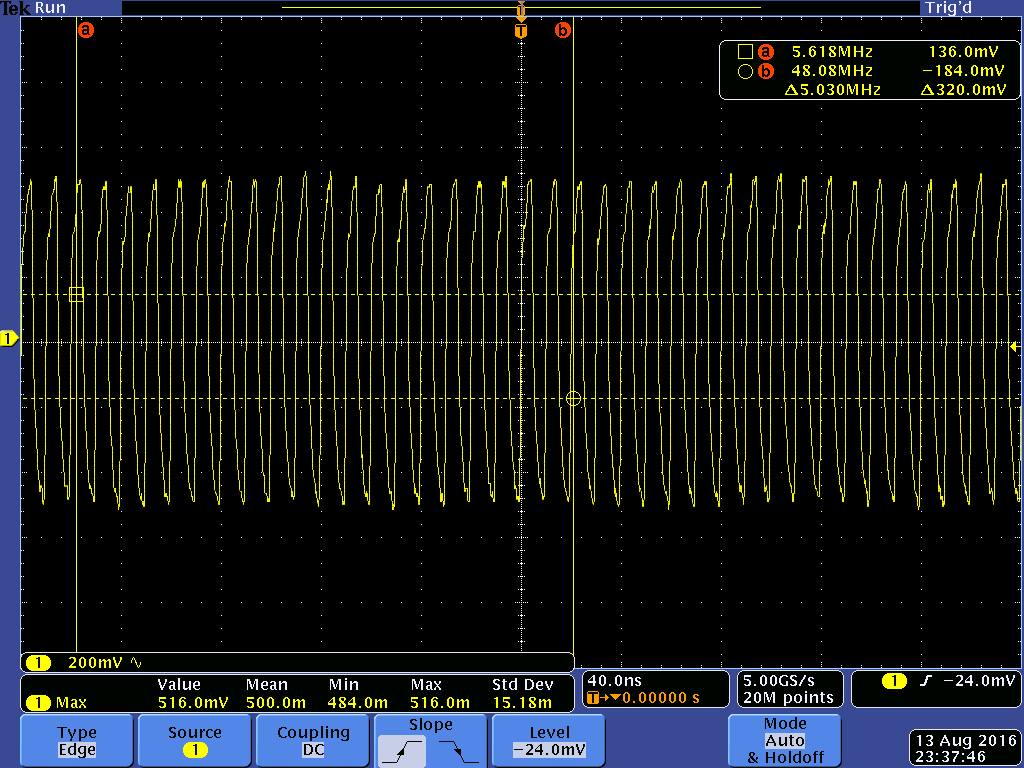

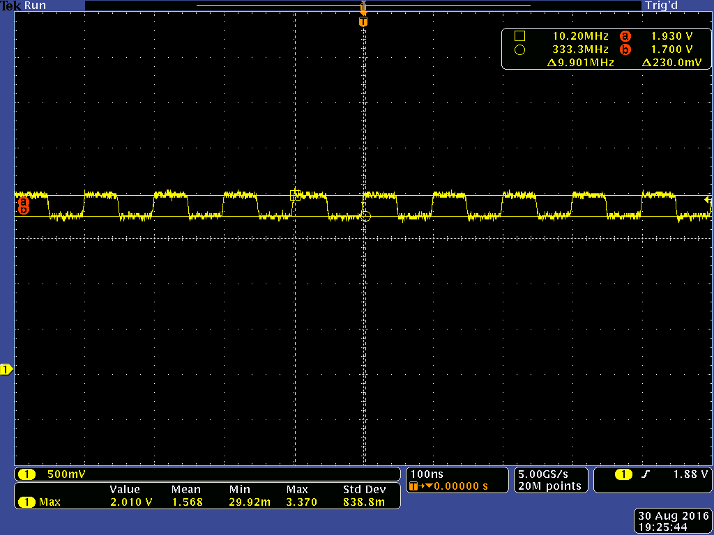

I had a PLL design that previously worked (see the thread 'CDCE72010 PLL fails to lock on FMC150 board'), but the design stopped working after a few weeks.  I checked the board for signs of damage near the VCXO and there does not seem to be an issue.  The original (working) register settings for an external 10MHz clock source were as follows:
