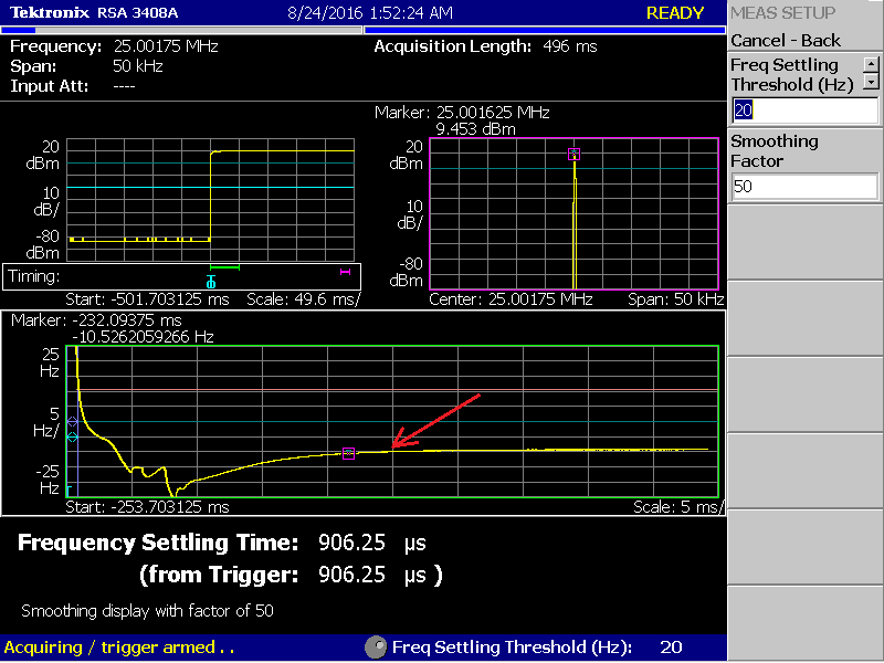

They generated a delay by applying a 47nF capacitor to gnd on the RESET pin.
They don't use the recommended crystal.(datasheet P.11 Table 1)
Their crystal is FA-238 (Epson).
They failed VCO calibration at some temperature conditions.
They want to get the appropriate delay in their crystal.

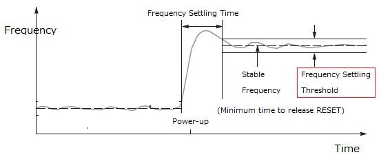

I introduced a method to identify the frequency settling by using signal source analyzer.
[Q]
Please tell me the frequency settling threshold where VCO calibration becomes certain, if stable (steady state) oscout frequency is 25MHz +/- 0ppm.

    I show additinal information as follows.
    Their temperature conditions are as follows.
     * Their test temperature range = -5deg to 60deg.
     * The temperature condition that the device fails = around 15deg.
    They tried that they delayed the RESET trigger.
     * 50ms delay -> NG
     * 80ms delay -> OK
    They want to know the appropriate RESET timing.
    Therefore I measured the frequency settling sample waveform in CDCM6100xEVM.
    The measurement waveform as follows. (This is just sample waveform.)
    I measured this in a default conditions.
    [Q]
    For example, Does VCO Calibration not fail at the red arrow timing ?

  • Hello Katsunaga-san,
    after the crystal generates a stable frequency the calibration should work fine. i would recommend to use the longer delay to have the crystal oscillation stable.
