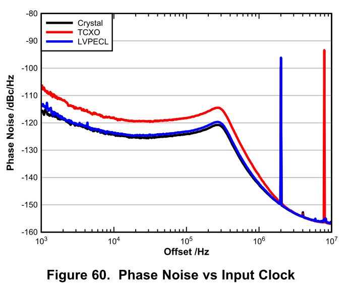

Hi Team,
Could you please tell us the condition for the following figure 60, Phase Noise vs Input Clock characteristic ?
Is PDF all the same condition for crystal, TCXO and LVPECL, as 26MHz ?
Kawai
  • Hi Kawai-san,
    The test condition is same for all type of inputs being used.
    OSCin = 26MHz
    fpd = 104MHz
    Prescaler = 2
    DEN = 2^24
    Fout = 480MHz
    Dither = Disabled
    3rd order modulator
    PFD_Delay = 4
    Total Icp = 2.5mA
    Default EVM loop filter
  • Hello Noel-san,
    Thank you for your reply.
    fpd is limited to 40MHz when used in crystal mode, so fpd would be different for each type of inputs.
    I believe input reference clock 26MHz and Fout 480MHz is the common condition for all types.
