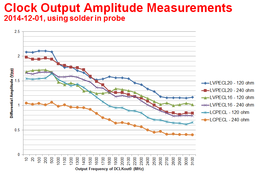

I am planing on using the LMK04828 LVPECL outputs at 3.0GHz,
Can you provide any output amplitude vs frequency data, or plots for the LVPECL, LVPECL16 and LVPECL20 outputs?

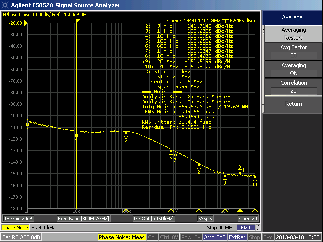

Is there any phase noise data, or plots available on the DCLKoutX outputs running at 3GHz?
