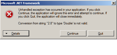

PLLatinum Sim error
Dear,
for users who get this error:
try to switch your language and regional settings to english(US).
