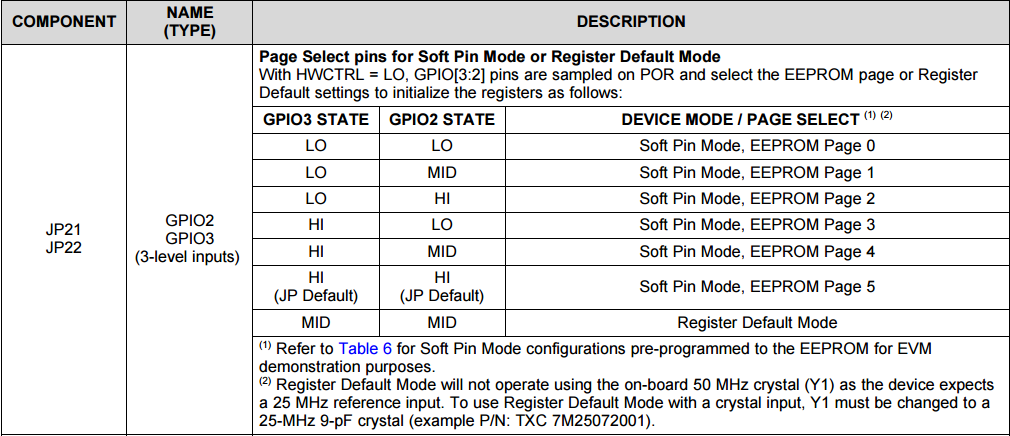

Could you let me know relationship of "R145 setting value" and "GPIO2:3=[00b] at HW_SW_CTRL = [0]" , please?
User wrote data to EEPROM with setting of R145[3:0] = 0010b =2(decimal).
But we cannot understand that which setting of GPIO2:3 should user select at Soft Pin Programming Mode.
Shimizu
  • Hi Shimizu,
    R145 (REGCOMMIT_PAGE) determines which EEPROM/SRAM page is written to when running REGCOMMIT (which copies the register contents to the SRAM for EEPROM programming). There are 6 total pages (page 0 to 5).
    Then, after programming the EEPROM, GPIO2:3 are used to select which of the 6 EEPROM pages the device will load its registers from upon powering on. See table 3 in the LMK03328EVM User's Guide for a clearer description of which GPIO values correspond to which pages (reproduced below):
    In your case, since you wrote to EEPROM page 2, you would need to set GPIO2 high and GPIO3 low to start from page 2 on startup.
    -Tim

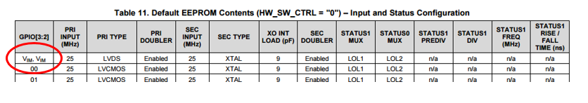

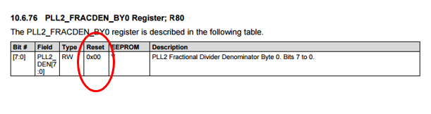

  • Hi Tim,
    Thank you for your support.
    I had a question.
    What is "Register Default Mode"?
    In datasheet, There is default value at reset.
    And In datasheet, There is setting at GPIO2/3=Vim/Vim.
    Is above two information the same mean?
    In other words, Does  "Register Default Mode" mean to become register to reset value?
    Shimizu
  • Hi Shimizu,
    That's correct, both of those charts describe Register Default Mode. Those register/device settings are the same.
    -Tim
