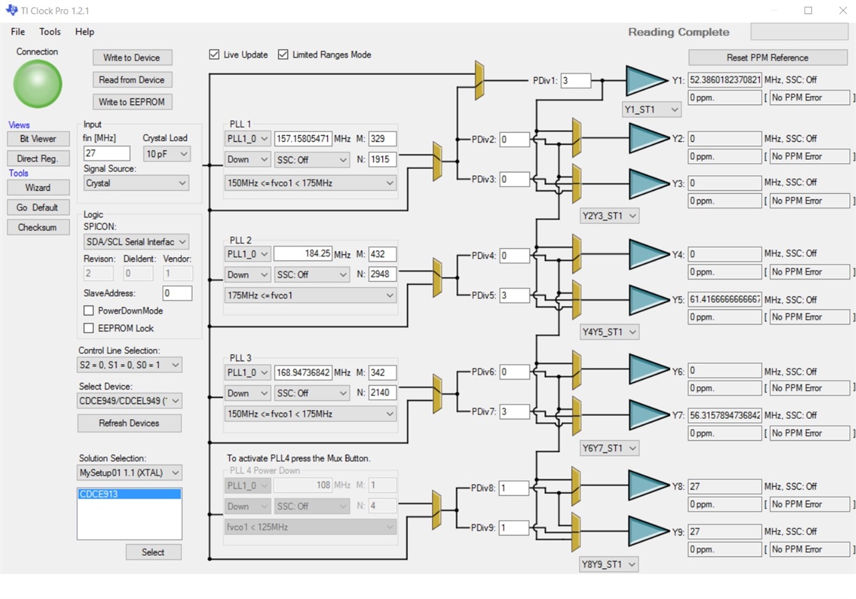

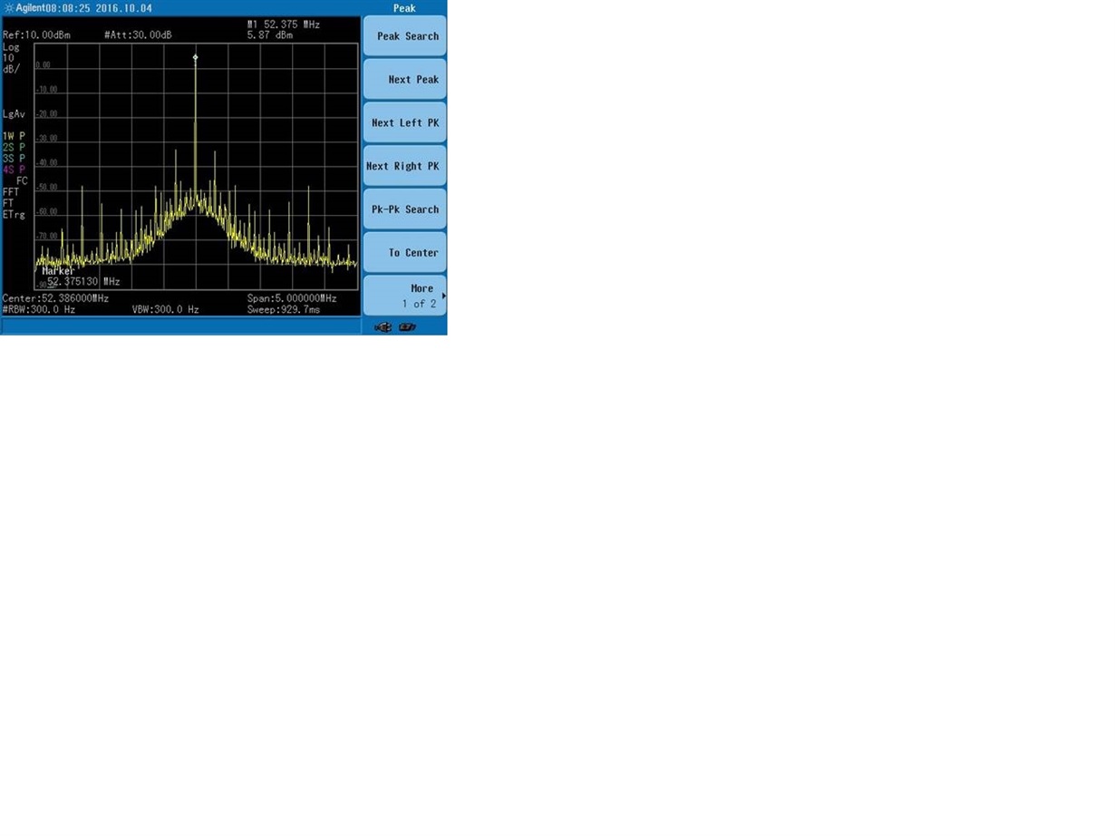

The spectrum I get from the device isn’t very clean, which is causing problems with the DDS it’s driving (see the image below).
The evaluation board was powered by a clean linear power supply, and the setup file is attached. The spread spectrum feature is turned off.
Please let me know what is wrong with the board.
I have attached the configuration file

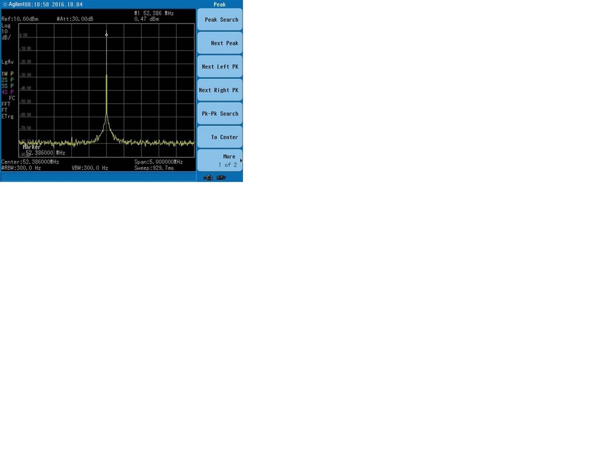

The other JPG is the output of the board
