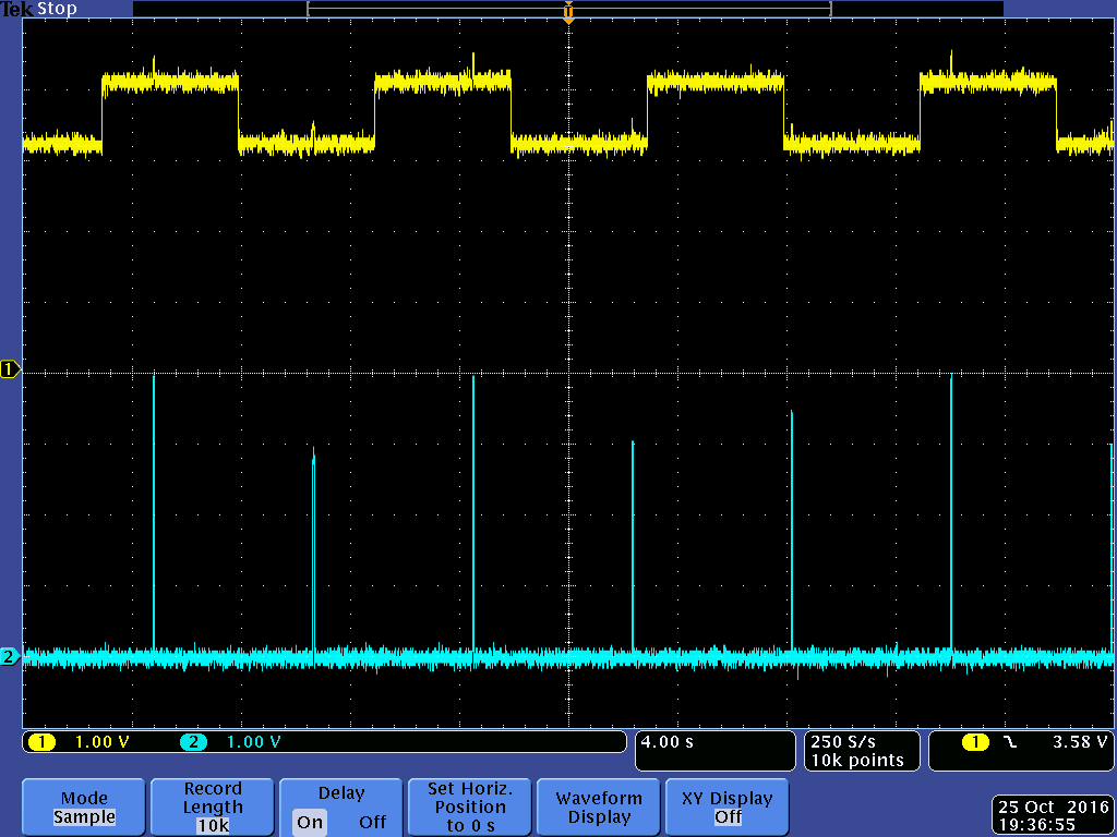

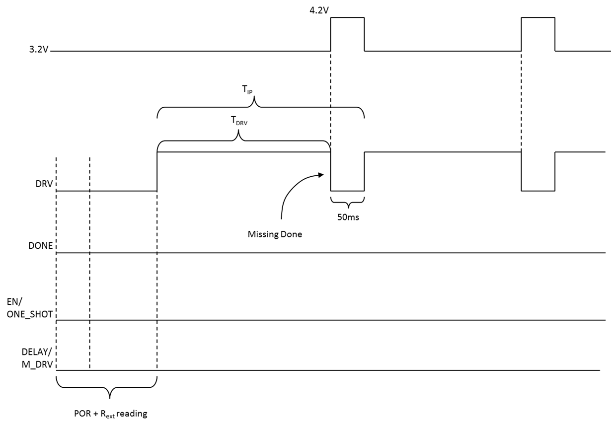

If VDD jumps from about 3.2V to about 4.2V It looks like the TPL5111 treats this like a power-on event and after about 80ms asserts the DRV signal.
Is this known behavior?  What are my options for getting around it?
In the oscilloscope screenshots below:
trace 1 is pin 1 (VDD)
trace 2 is pin 5 (DRVn)
pins 2 (GND), 4 (DONE), and 6 (EN/ONE_SHOT) are shorted to ground
pin 3 has a 10k pulldown to ground.

    looking at your trace it doesn't seem a "false" POR detection.
    In your traces seems that the DRVn change before the VDD change.
    I don't know your schematic, but Is it possible that the DRVn shut down a portion of the system and this cause the change in VDD>
    Anyway, TPL5111 sequence on POR is that the VDD change and after 200ms the DRVn is asserted HIGH (not low as in your traces) until a DONE signal is received OR it reach the end of the programmed time interval.
    Time interval is programmed via the external resistance.
    Could you please verify the sequence DRVn and VDD jump again?

    In the lab we use a TPL1110EVM powered with a power supply that periodically change its value from 3.2V and 4.2V.
    To well identify the possible POR event the change in the voltage supply are asynchronously generated respect to the timer period. POR event is not triggered
    Fig 1
    Based on our test I will exclude that the unwanted POR event when the power supply change from 3.2V to 4.2V

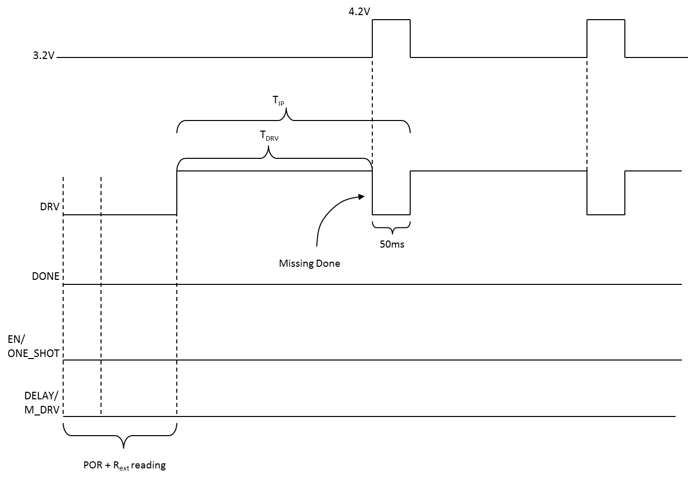

    I would like to come back to the “Missing done” behaviors of the TPL5110/TPL5111
    Fig 2
    Figure 2 describe the TPL5111 missing done behaviors.
     As you can see the behaviors is very similar with what you described and the fact that the DRV drives the 4.2V LDO making the events happen at the same time. In the below figure I also added the voltage supply value that bounces between 3.2V and 4.2V
    The above description should describe the behaviors you are seen on your application

  • Did you have EN/ONE_SHOT set low on the TPL5110EVM you used for Figure 1?
    Is trace 1 the VDD pin and trace 2 the DRV pin in Figure 1?
    Are you saying that if DONE is NEVER pulsed, then DRV will continue to pulse hi/low forever even with EN/ONE_SHOT set low?  (That's what your Figure 2 is showing?)
    If that is the case, then the datasheet needs to be corrected.
    Right now it states:
    When EN/ONE_SHOT = HIGH, the TPL5110 works
    as a TIMER. When EN/ONE_SHOT = LOW, the
    TPL5110 turns on the MOSFET one time for the
    programmed time interval. The next power on of the
    MOSFET is enabled by the manual power ON.
    and
    During One shot mode (EN/ONE_SHOT = LOW), the TPL5111 generates just one pulse at the DRVn pin which
    lasts according to the programmed time interval. In one-shot mode, other DRVn pulses can be triggered using
    the DELAY/M_DRV pin. If a valid manual power ON occurs when EN/ONE_SHOT is LOW, the TPL5111
    generates just one pulse at the DRVn pin. The duration of the pulse is set by the programmed time interval. Also
    in this case, if a DONE signal is received within the programmed time interval (minus 50 ms), the DRVn output is
    asserted LOW.
    That means that if EN/ONE_SHOT is low you get one DRV pulse on power up and never again until M_DRV is pulsed or VDD power cycles.
    I also don't believe the "missing done" explanation because if it were true my board could never get out of a repetitive power cycle.  The DONE pin is shorted to ground on my board.  There is no way for me to pulse it, but if I prevent the 3.2V-4.2V oscillation my board starts up fine and continues working without power cycling.

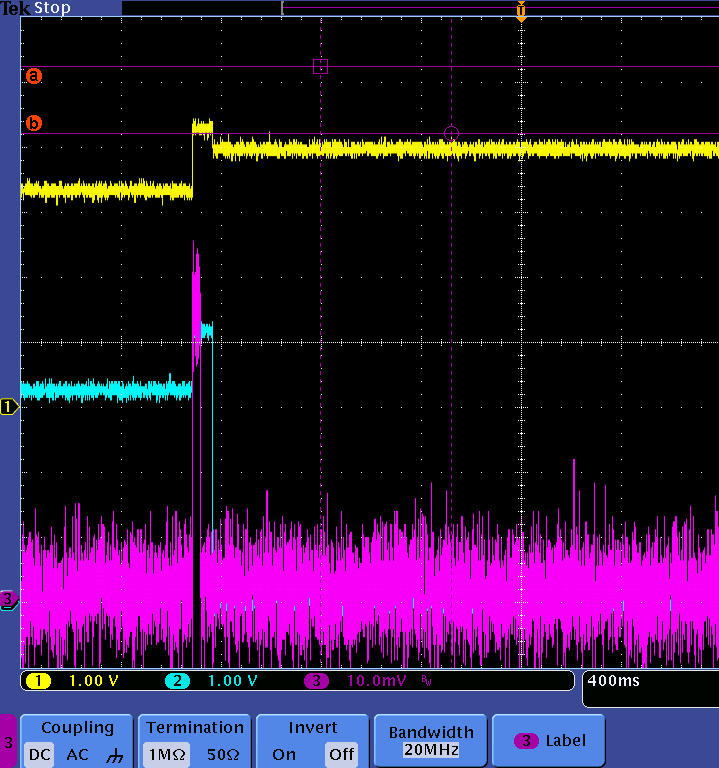

  • Dear Douglas
    The graph reported in the previous post was made on an TPL5110EVM in timer mode.
    We have just replicate the set up you indicated an with a VDD variation a Power On Reset event is triggered.
    Only on the rising edge of the VDD triggers the event
    We are doing further investigation on this behaviour, we will add the results in the next datasheet release.
    Please find below an oscilloscope capture that indicate the POR.
    - Yellow = VDD
    - Blue = DRV
    - Purple = DELAY/M_REST
    Best Regards
    Massimo
  • I'm glad that you were able to reproduce it and that you're going to update the datasheet.
    Do you have an idea of when the updated datasheet will be available?
