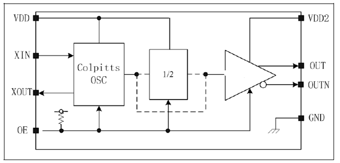

Hi Sir,
Do we have solution can support 3rd overtone oscillator?
LVPECL ouput and 155.52Mhz.
The block diagram as below
Thank you
Hi Jim,
We do not have any overtone oscillators in our portfolio. A lot of customers that we have engaged with had expressed concerns with high rate of failure when using overtone oscillators in their design. The ability to "frequency pull" the crystal also reduces with overtone crystals.
