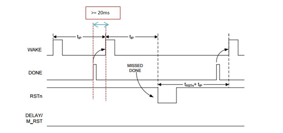

    To answer your first question:  The output pulse on the WAKE pin is only seen if a DONE signal is received from the MCU within the required time period. The WAKE signal is normally low unless otherwise triggered by the receiving of a DONE. The TPL only recognizes a valid DONE signal as a valid low to high transition. So in other words, to "enable" the WAKE output, it must be followed before by a valid DONE.
    To answer your second question: The TPL will not output a WAKE if no DONE input is received. Instead, a periodic RSTn signal will take place. The period of the RSTn (as seen on Pg. 8 of the datasheet) is the sum of RSTn Pulse width and your 500ms. However, in your case the weight of the RSTn width will affect your timing for a 2Hz clock. You can try reducing the value of  the time interval (to around 200ms) and effectively attain roughly a 500ms period pulse, granted precision is not a concern.

  • Hi Jake,
    If a DONE signal is supplied to the TPL (at least 20ms before the rising edge of the next WAKE pulse) and that signal stays high, then only one WAKE signal will be issued which will kickstart the beginning of the next time interval. To get another WAKE pulse afterwards, you must issue another DONE (low to high transition), again at least 20ms before WAKE's rising edge. The timing of the WAKE is purely dependent on the interval selected. Receiving a DONE in the valid timefame only tells the TPL that a WAKE is to be issued at the beginning of the next time interval.

  • Hi Jake,
    To answer you question, the WAKE will never output a pulse unless a DONE transition of low to high is registered. Upon startup, if DONE is low, then WAKE is also low. Instead you will see a periodic signal on the RSTN pin (acting as if a DONE is "missed")
    Again, the timing of the WAKE pulse output is at the start of the chosen interval period and does not depend on when a DONE is issued.  As long as a DONE is issued at least 20ms before WAKE's to-be rising edge, which occurs at the beginning of every time period, a WAKE will be issued.
