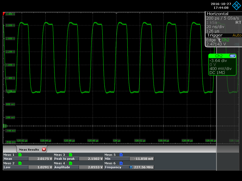

  • Hi Timothy
    The tuning voltage is 0 to 3.3V.
    I have changed the resistors as you've suggested but I still haven't managed to achieve lock. The signal has the following waveform.
    The signal seems to be within the parameters of the datasheet.
    About the R3 and R4 they are connected, as you've said it's an ilustration error.
    The REF path is fine, I can see that the correct reference is being used through the status ref pin. They are both LVCMOs going directly to the CDC.
    Tiago
