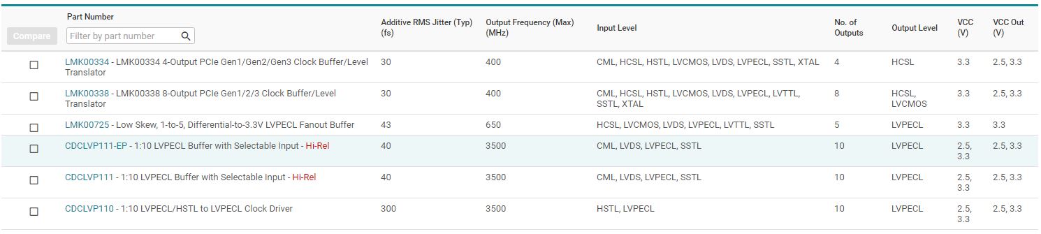

We are asked for clock buffer which supports SSTL, HSTL, and POD memory interface input.
POD is Pseudo Open Drain interface which seems to be used from DDR4-SDRAM.
Do we have any clock buffer which supports below interfaces ?
INPUT : SSTL, HSTL, POD
OUTPUT : LVDS or LVPECL or LVCMOS
I can find below devices, however, did not know if these can support POD interface for input.
Thanks in advance.
Kawai
