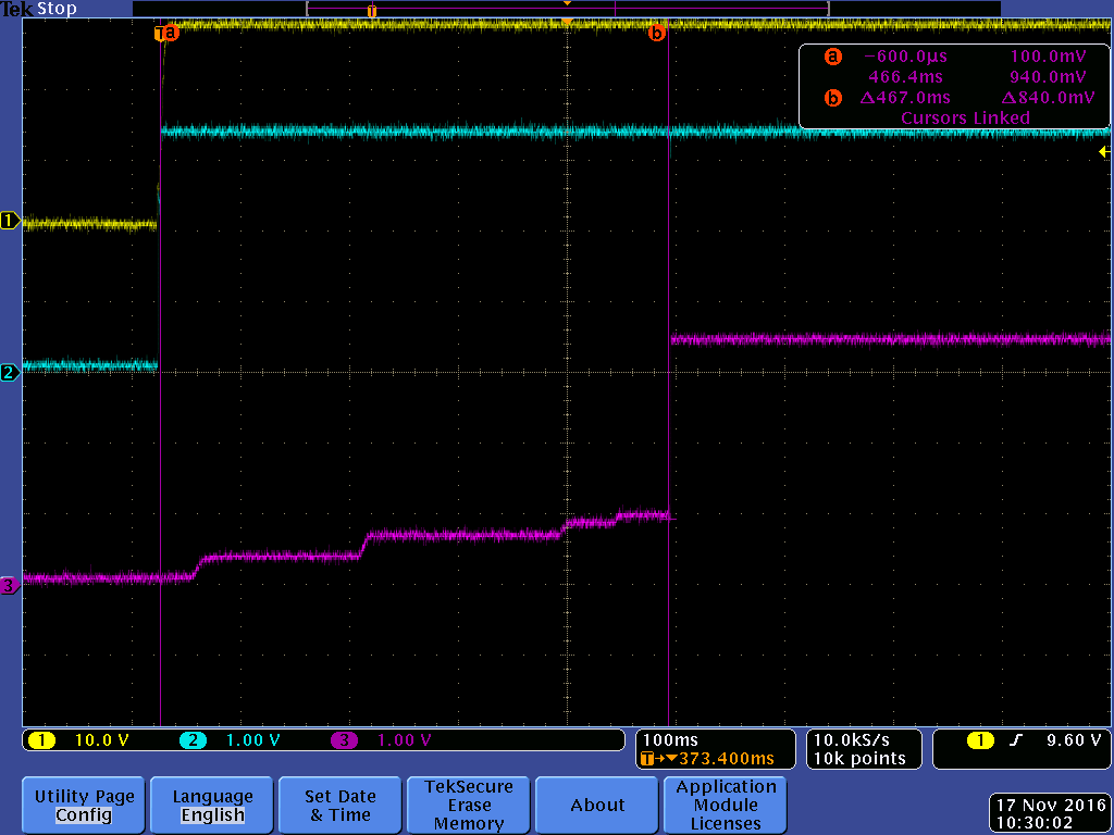

We have currently implemented the CDCE62005 in two different ways. One with the Power Down pin tied to VCC_OUT (in this configuration the synthesizer becoming unlocked around 30% of the time), whereas in another configuration the power down pin is connected to the FPGA (the pin is pulled down during power up and then driven high once the FPGA is configured) they don’t see the issue (I can provide schematics if you connect with me on e2e or I can also email them).
Seeing as one of our TI reference designs (TSW6011 EVM) also ties Power Down to VCC_OUT, I’m wondering if issues have ever been seen with that design or if maybe their problem stems from something else?
I interfaced previously on this with another person from the clocking team and they asked us to add 0.1uF of capacitance on the PDN to solve the issue. In the setup with PDN tied to VCC_OUT, we noticed that VCC_OUT is a 3.3V regulated supply with already 770nF of capacitance. We wanted to ask if we could try an LC circuit to isolate the capacitance in efforts to hold PDN low, longer? In table 4 of the datasheet it mentions after the power supply reaches approx. 2.35V, the contents of the EEPROM are copied into the Device Registers. Is this the voltage level the PDN considers a low-to-high transition?
Do you have any other comments on this or have you ever heard of this occurring before?
  • Update:

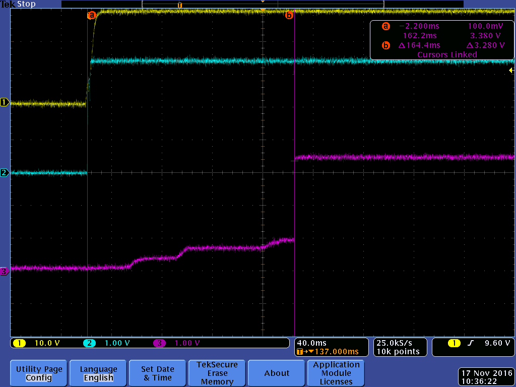

    Another characteristic the customer is noticing is that their supply is not monotonic and that it actually progressively steps up as other supplies turn on (supply to synthesizer is turned on by FET). They were able to reduce the turn-on time from when the main 3.3V supply turns on to when the supply to the synthesizer turns on (please see scope shots below, first is long power up, second is short) but I’m guessing this could still be a cause of the instability/loss of lock they’re seeing?

  • Hello Amanda,
    can you please clarify which of the scope channels is the 3.3V of the CDCE62005?
    SPI_LE must be at static high level before the !PDN goes to high level for the EEPROM loading into the registers and VCO calibration being started.

  • Hello Patrick,
    Thanks for your quick response.
    "can you please clarify which of the scope channels is the 3.3V of the CDCE62005?"
    -The Legend for the scope is as follows (my apologies, I forgot to include):
    Channel 1: 28V supply into the board
    Channel 2: Main 3.3V
    Channel 3: 3.3V Supply for Clock Synthesizer

  • Hello Amanda,
    thanks for sharing the settings. These are fine. So it seems this is related to our startup getting confused.
    As you mentioned above it will be important to delay the powerdown pin signal and still keep a fairly good slew rate on the rising edge. The FPGA working fine is basically matching that theory.
    Patrick

  • Hello Amanda,
    as you already wrote. they will have to add a FPGA or MCU to control the startup. When they add a lot of analog delay they will run into the slew rate + noise issue.
    I think adding a cap of  2.2nF to 4.7nF should introduce enough delay when a MCU is not an option.
