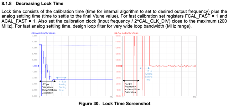

The  datasheet describes an example of Lock Time with somewhere around <100uS order.
However my customer has reported that the lock time on their system is longer than 10mS.
Can you help to make sure whether this is expected or something wrong on register settings?
I have ask customer to change ACAL_FAST and FCAL_FAST.
The register setting and tcs file are attached.
Thank you for your support in advance.
Please let me know, if you need further information.
Ken

  • Hi Ken,
    As you see in the example we used the 200MHz OSCin with CAL_CLK_DIV=0 which gives a calibration clock of 200MHz, this is a dominant factor in the amplitude calibration time. Basically if you have OSCin of 100MHz, your total calibration time is about two times as long. So with 20MHz, you are somewhere around 10 times as long as the example. One option you have is just turn off the amplitude calibration, by setting ACAL_EN=0, then you should see much faster calibration times by skipping this function. You can then set the amplitude manually by doing VCO_IDAC_OVR=1 and then setting VCO_IDAC (around 350 - 400 you should see the best VCO phase noise) to manually optimize the VCO amplitude.
