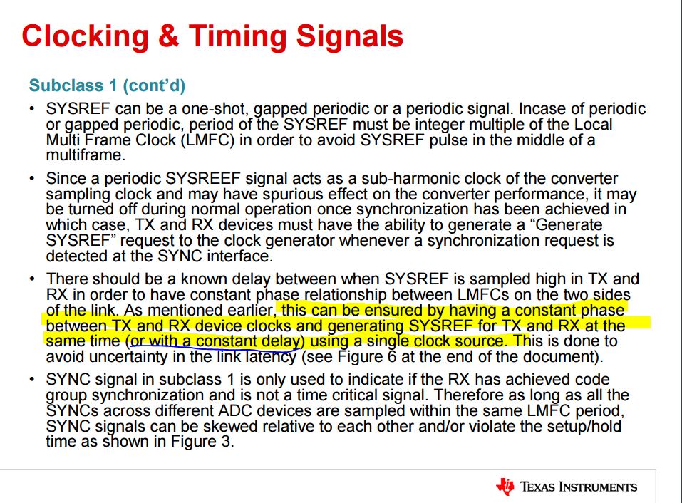

To my understanding I comply with the JESD clocking requirements:
- DEVCLK & SYSREF of  Tx ( ADC) are provided from the same LMK and will be routed together (same trace lengths).
- DEVCLK & SYSREF of  Rx (FPGA) are provided from the same LMK and will be routed together (same trace lengths).
- To my understanding it is OK to have a SYSREF to SYSREF delay. this is based on a TI JESD204 presentation & snau139:
        * "The only thing that matters for JESD204B is SYSREF to Device Clock timing for the same device. Not SYSREF to SYSREF"
        * need for "generating SYSREF for TX and RX at the same time (or with a constant delay) using a single clock source" [snau139 slide 6] see attached image            below:

    Since you show SYSREF from both LMK0482x, you need to align them/SYNC them somehow.  One way may be treat one of the devices, as the master and then drive a SYSREF into the CLKin0 of the other to SYNC it's SYSREF divider... or to just distribute directly.  Note, right now we don't have the setup and hold windows defined for CLKin0 (SYSREF) to CLKin1 (Device Clock) SYSREF distribution.
