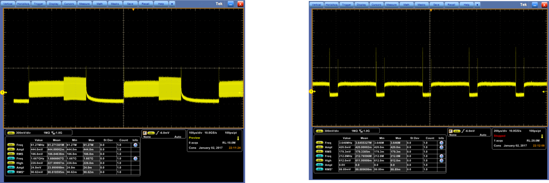

In my design I need to supply clocking for a JESD204B interface by using a Arria V FPGA to configure lmk04821.
According to Key Points to Setting up SYNC & SYSREF on LMK0482x with CodeLoader.pdf, i write a configuration file as below but the clock output is wrong.(left is dclk output and right is sysref outout)
Can you tell me whats wrong and how can i solve my problem? Thank you.
The  configuration sequence is shown as below:

  • Something different now. There is only correct DCLK output but nothing with SDCLK.
    What is the problem?
    Need your help. Thanks!

    The newly configuration sequence is as below.
    Still, DCLK output is correct but there is nothing with SDCLK.
    I don't know why and hope to hear from you soon. Thanks a lot!

    R115= 24'h011C_22,
    R116= 24'h0124_22,
    R117= 24'h012C_02,
    R118= 24'h0134_02,
    R119= 24'h013C_00, // set the delay of the SYSREF digital delay value 66666666666
    R120= 24'h013D_08,
    R121= 24'h0144_00, // SYNC_DISSYSREF, SYNC_DISX=0 666666666666 To allow SYNC to effect dividers:
    //------------------- 2 Perform SYNC by toggling SYNC_POL = 1 then SYNC_POL = 0.-------------------------
    R122= 24'h0143_B1, // SYNC_POL=1, SYNC_EN=1,SYNC_MODE=1 SYSREF_CLR = 0
    R123= 24'h0143_91, // SYNC_POL=0, SYNC_EN=1,SYNC_MODE=1 SYSREF_CLR = 0
    //-------------------3 disable SYNC from resetting these dividers.-------------------------
    R124= 24'h0144_FF, //
    //-------------------4 Release reset of local SYSREF digital delay.-------------------------
    R125= 24'h0143_11,// SYNC_POL=0, SYNC_EN=1,SYNC_MODE=1 SYSREF_CLR = 0 SYNC_MODE = 1
    //------------------- 5 Set SYSREF operation -------------------------
    R126= 24'h0139_03, // Now asserting the SYNC pin, or toggling SYNC_POL will result in a series of 2 SYSREF pulses.?
    //-------------------Misc Registers-------------------------
    R127= 24'h1FFD_00,
    R128= 24'h1FFE_00,
    R129= 24'h1FFF_53;
    I tried the above configuration and was able to successfully program the device.  I didn't try reproducing the exact order that you have, but rather just programmed the final set of registers.  I did have to use 122.88 MHz as a reference frequency because the eval board uses 122.88 MHz VCXO, this resulted in me changing the PLL2 N from 5 to 4 so that it would lock at 2949.12 MHz.

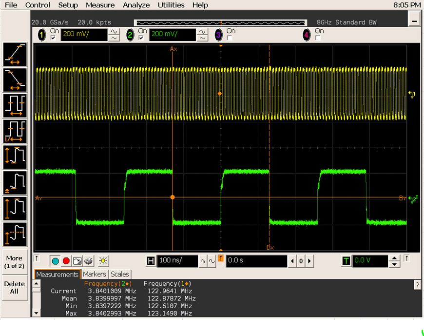

    Is this being tested on more than one board?  Can you use this code to power/power down the device (or toggle an Status_LD pin by using PLL2_LD_TYPE to change output to inverting?).
    Here is the example plot I collect, note the output frequency is changed slightly as my VCO is at 2949.12 MHz.  I think your VCO normally operates at 3000 MHz and would then produce 125 MHz from the output I tested:
    73,
    Timothy
  • From your image above, it appears your SYNC_DISX/SYNC_DISSYSREF bits are not set and the SYSREF divider is resetting itself... but your register map is proper to set register 0x144 = 0xff for final operation.
    73,
    Timothy
  • Thank you for your reply but there is still nothing with my sysref output.
    I wonder if you can give me your whole register configuration file, which contains value and sequence.
    Thanks!
    Sorry for the delay. Please note that the TICS Pro software (TICSPRO-SW) now supports the LMK04821 directly. You might try clocking SYNC/SYSREF page, then clock 'Continuous' for continuous SYSREF. This may help you get a config to generate SYSREF.
    Ensure your desired SDCLKoutY_DIS_MODE is set to active.
    Then on the Clock Outputs page select "SYSREF" for the output in question and uncheck SDCLKoutY_PD.
    Let me know if you're still having issues.
    73,
    Timothy
