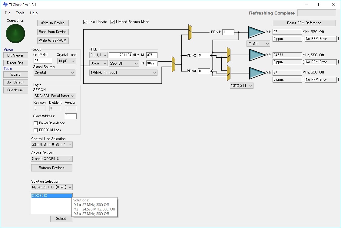

Hi, All
I'm using Clock Pro to generate setup below.
Y1=27Mhz, Y2=27MHz, Y3=24.576MHz.
but the generated set up is for Y1=27MHz, Y2=24.576MHz, Y3=27Mhz.
(manually, I can set Y1=27Mhz, Y2=27MHz, Y3=24.576MHz.)
I'd like to know if there is any limitation on frequency selection.
wizard
generate setup
