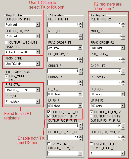

Hi team,
My customer wants to use LMX2571 as two fanout outputs.
So, the customer asks how to set the T/R switch to be configured as a fanout buffer to out
the same signal at both RFoutTx and RFoutRx ports at the same time.
Please let me know the related register settings and the TrCtl pin setting.
