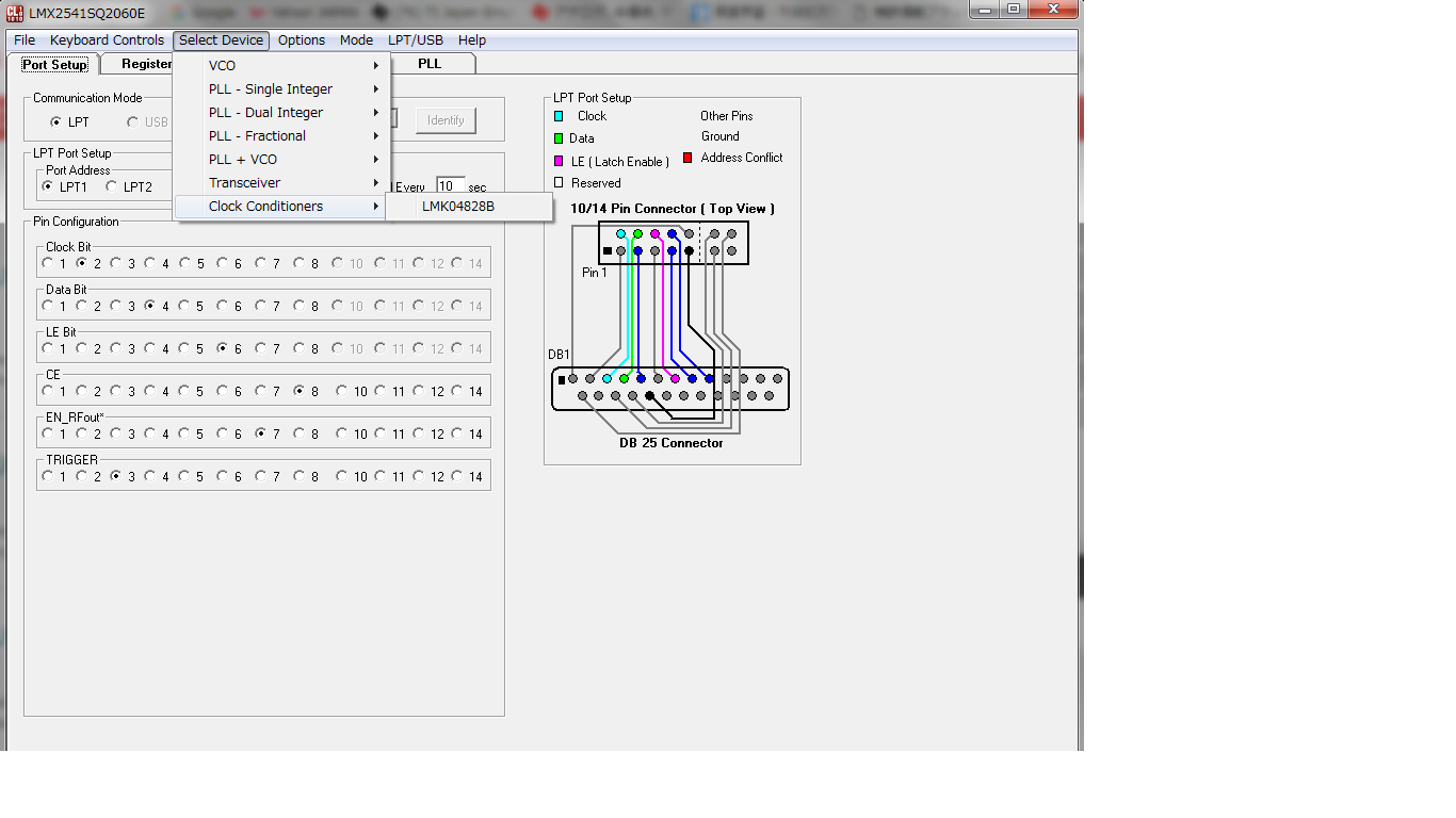

Codeloader4: Only LMK04828B appears in clock conditiners of select device
Other Parts Discussed in Thread: CODELOADER, TICSPRO-SW
In my Codeloader, only LMK04828B appears in select device as attached. I installed the latest version. What is the possible reason not showing another devices? Ini file is attached if it may be related.
https://e2e.ti.com/cfs-file/__key/communityserver-discussions-components-files/48/codeldr.ini
Toshihiro Watanabe
    I think your issue is related to the VirtualStore.  When UAC (User Access Control) is enabled windows prevents writing access to the program directories.  This means any writes are written to a user data location located under virtual store here:
    C:\Users\<your_username>\AppData\Local\VirtualStore\Program Files (x86)\Texas Instruments\CodeLoader 4
    If these exist, then the program file version is no longer used.  Delete the above directory and you will see all devices from the latest install file.
    If using LMK0482x, I actually recommend that you download our new software called TICS Pro. (ticspro-sw), as it has an updated interface for the LMK0482x devices.  It also resolves this type of software issue for updates.
