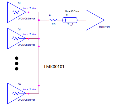

LMK00101: Can I connect all the output of LMK00101 or other clock buffers to enhance drive capability?
Part Number: LMK00101
The connection is as follows:
Is there any technical manual for reference?
Is there anything to pay attention to?
Please help
    The answer is NO, because you can't align all drivers. When one driver output high, another driver is still in low. They will be burned.
    Why do you want to enhance the drive capability? What's that receiver?
