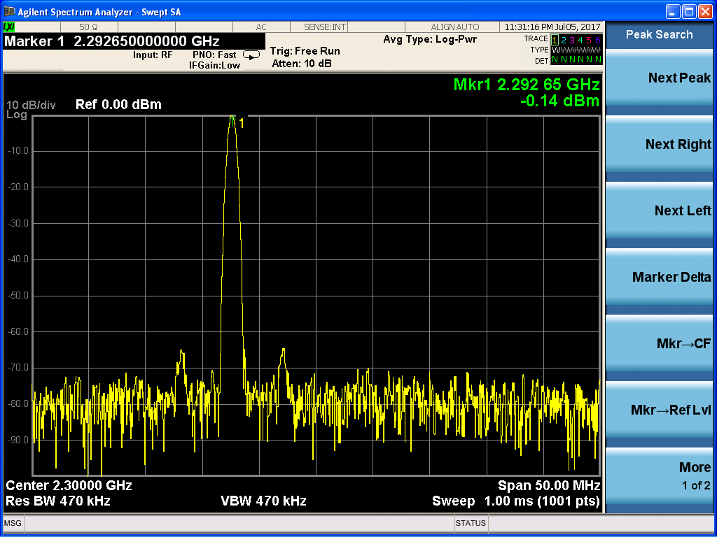

I am trying to configure the LMX2582 to output a frequency of 2304 MHz, however I am not able to acquire the wanted frequency. Using the included equation for the VCO I have calculated for my values to as such:
Fpd: 122.88MHz
PLL_N_PRE: 2
PLL_N: 18
PLL_NUM: 3
PLL_DEN: 4
FVCO = 4608 (before the /2 divider segment.)
However at the output I am getting 2292.43MHz, but I am not exactly sure how that value is being calculated.
Are my calculations correct?

    What is is your reference clock frequency? If it is 122.88MHz, did you check that it read 122.88MHz in your test equipment?
  • Hi Noel,
    My reference is 122.88 MHz and yes I made sure to check that the 122.88MHz is present.
    Oscar
  • Hi Oscar,
    Your PLL frequency planning is correct, it should work. If your test equipment also read 122.88MHz for the reference clock, then you should get exactly 2304MHz from the synthesizer. Another thing you can try is put PLL_NUM=0, i.e. an integer channel, see if you can get what is expected. If you cannot get what you want, please provide your register setting for us to review.
  • Hi Noel,
    I tried the setting PLL_NUM to 0 and I do get what I expect. However the issue persists when I try to add in the fractional portion. .Attached is the configuration that I am using in order to try to obtain 2304 MHz from the LMX.
    LMX_2304.cfg
    Thank you,
    Oscar
  • Hi Oscar,
    I think you have missed programming some registers, for example, R2 and R4. Furthermore, there are some register bits not correctly set.
    Please try the attached setting. I assumed you will use RFoutA in the setting.
