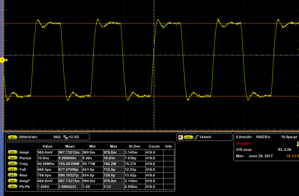

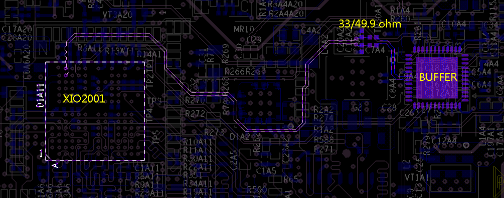

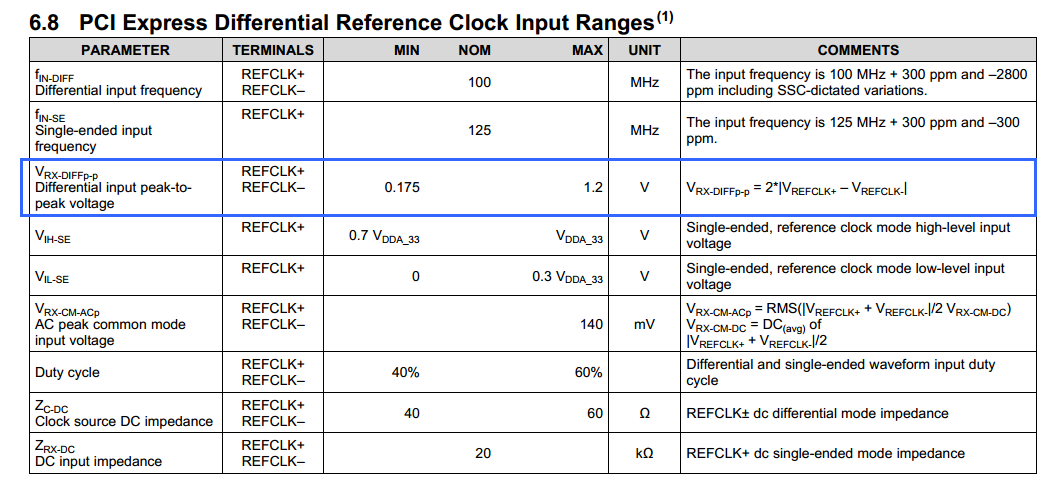

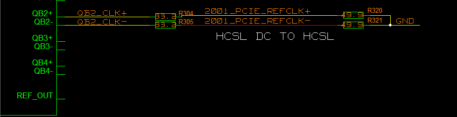

My customer adopt LMK00301 to output REF CLK for  XIO2001. Output format is HCSL, Current VPP is 1.6V, bigger than 1.2V max. If we adjust R320/R321 to 27ohm to get Vpp less than 1.2V, is LMK00301 ok for this change? Thanks!
