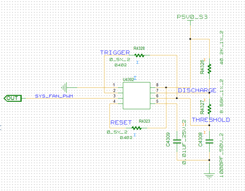

Hi Team,
Customer would like to use LM555 to send out PWM duty cuty 15% in 25KHz modulation frequency.
Could you provide the recommended RA and RB and C? is that ok to follow figure 14 circuit?

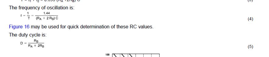

    I'll start with duty cycle formula and solve for Ra
    D = Rb / (Ra + 2Rb)
    (Ra+2Rb) = Rb / D
    Ra = Rb / D - 2Rb
    Ra = Rb * (1/D - 2)
    Ra = Rb * (1/15% - 2)
    Ra = Rb * 14/3
    Now I'll move to frequency formula and solve for Rb and C
    F = 1.44 / [(Ra + 2Rb) *C]
    (Ra + 2Rb)*C = 1.44 / F
    (14/3*Rb + 2Rb) * C = 1.44 / F
    20/3*Rb*C = 1.44 / F
    Rb = 3/20*1.44/(F*C)
    Based on chart 1nF to 10nF is good.
    I'll pick 1nF
    Rb = 3/20*1.44/(25kHz*1nF)
    Rb = 8.64k; Ra = Rb*14/3 = 40.32k
    However the formulas do not compensate for propagation delay.
    For NE555, I substitute F * (1+F/350kHz) for F. LM555 correction will be similar.
    New F used is 25kHz * (1+25kHz/350kHz) = 26.786 kHz
    Rb = 3/20*1.44/(26.786kHz*1nF)
    Rb = 8.064k; Ra = Rb*14/3 = 37.63k
  • Hi Ronald,
    Thanks for great support.
    Could you help review the schematic?
    SHH
  • Hi Ronald,
    SHH
  • SHH,
    I suggest a bypass capacitor between pins 8 & 1 (VCC and GND)
    I want to test the timing components. I believe I can find time on Thursday to do this.
  • SHH,
    I built the board with the values close to my  Rb = 8.064k; Ra = 37.63k prediction but the output frequency was too low due to higher propagation delay than expected.
    I picked new resistors scaled by observed frequency error and capacitor tolerance error. Using closest 1% resistor, the new Rb is 7.15k and Ra is 33.25k.
    My test resistors were within 0.2% stated value however the capacitor was 8.1% higher than 1nF.
    Therefore I expect the capacitor tolerance will be the largest variable for frequency but it should not affect duty cycle. The LM555 will add some frequency variability due to propagation delay variance.
    I noticed that the duty cycle is for the low output. The output was low 16% of the time. If a ~15% output high time is needed then the output can be inverted.

  • SHH,
    If I use the new values of Rb is 7.15k, Ra is 33.25k and C = 1nF using the data sheet formulas I get the following result.
    Duty cycle is 15.05% ; remember this is a low time duty cycle.
    Frequency is 30.32 kHz ; I had to try for 30kHz to get 25 kHz.
    So LM555 at 25kHz has negative duty cycle that is 1% higher than formula predicts.

  • Hi Ron,
    Appreciate for help.
    So if using LMC555, the schematic is the same. right?
    SHH
  • SHH,
    The schematic will be the same. Using your initial values of 8.66k and 40.2k should provide 24.7 kHz at 15% low time if C3408 is accurate.
  • Hi Ron,
    If customer need inverted waveform, which device you will suggest to add?
    SHH
  • SHH,
    a simple inverter using a single NPN or NMOS transistor is common.
