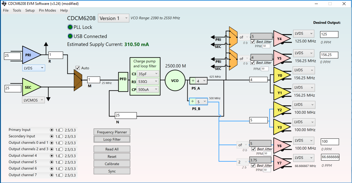

Please let me know whether it is possible to generate below mentioned outputs from single CDCM6208, using a 25 MHz external reference ( crystal / oscillator):
- One 125MHz
- Three 156.25 Mhz
- Three 100 MHz
- One 66.67MHz
Sine these clcoks are used as inputs for Keystone II devices, these must be clean and low jitter.

  • Hi Madhu
    Yes, it is possible. Please find attached the divider configuration generated with the Frequency planner.

  • Hi Puneeth,
    Thanks a lot for sharing the details.
    I have few queries related to the tool, after going through the tool and its user manual:
    In GUI:
    1) I am not using any primary input ( only a 25Mhz crystal). In the tool after disabling the primary input, if i turn the primary frequency to zero,
    VCO gives an error. Does this mean that it is necessary to connect a primary even if it is not used?
    IN Loop Filter Tool:
    2) In the user guide, For loop bandwidth, it is suggested to choose >100kHz if crystal is used. So i would like to know whether any value greater
    than 100kHz would be fine or is there any relation between crystal properties & required loop bandwidth?
    3) Whether CP current is related to Loop bandwidth? If yes, Is there any formula to relate these?
    4) Advanced setup involves terms like spur gain, gamma etc. Could you please provide some more information ( reference document if any)
    about these terms?
    In Phase Noise Tool:
    5) Could you please provide more information on Integration start/stop?
    Madhu
  • Hello Madhu
    Here are answeres to your questions:
    A:  No, it is not required to connect primary if you dont use it. In the EVM tool there is a AUTO tick box next to the input mux, just remove the tick and click on the mux, it will switch to the secondry input.
