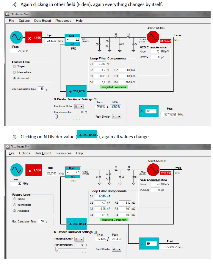

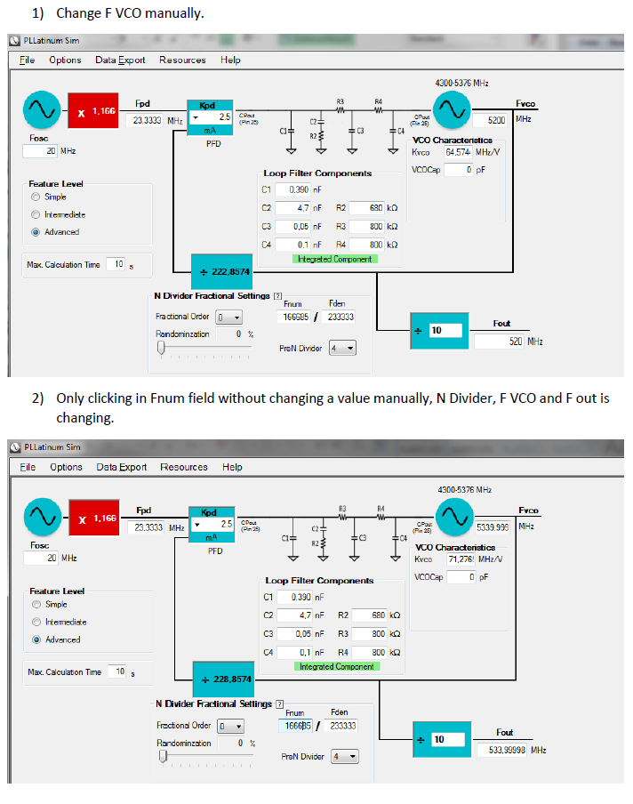

I'm trying to use PLLatinum Simulator. When I enter my desired and used values, strange things happen. The N-Divider changes automatically, just by clicking in a other field without changing this field.
Is this an error or wanted behavior?
I made some screenshots:
Thanks for the help and regards,
Alex

    Yes, whenever the cursor moves out of the box, it automatically enters the value and performs calculations.
    BTW, it looks like you are using a multiply of 7 with divide by 6.  Be aware that PLLatinum sim does not model the noise of the multiplier, but it adds on the order of 8 db to the PLL figure of merit.
    Dean
