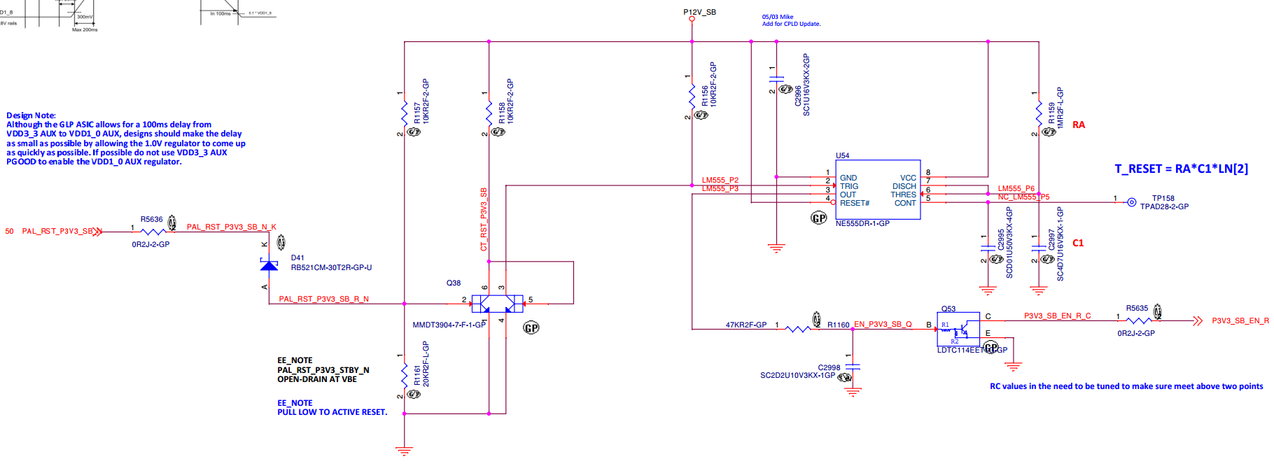

Hi team,
Could you please help to review the schematic of NE555?
  • Daniel,
    LM555 and NE555 are similar devices. The advice I gave for LM555 applies here too.
    The only thing I noticed was the T_RESET formula that doesn't match the LM555 formula for monostable.
    NE555 one shot time is 1.1*R*C
    LN(2) is the time from 1/3 to 2/3 charge. For one shot the capacitor goes from 0V to 2/3 VCC (just over one time constant)
