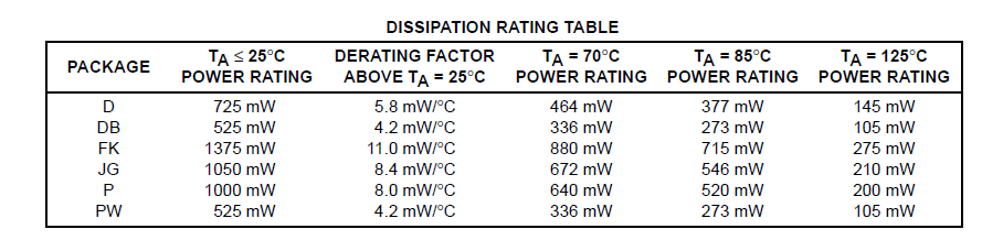

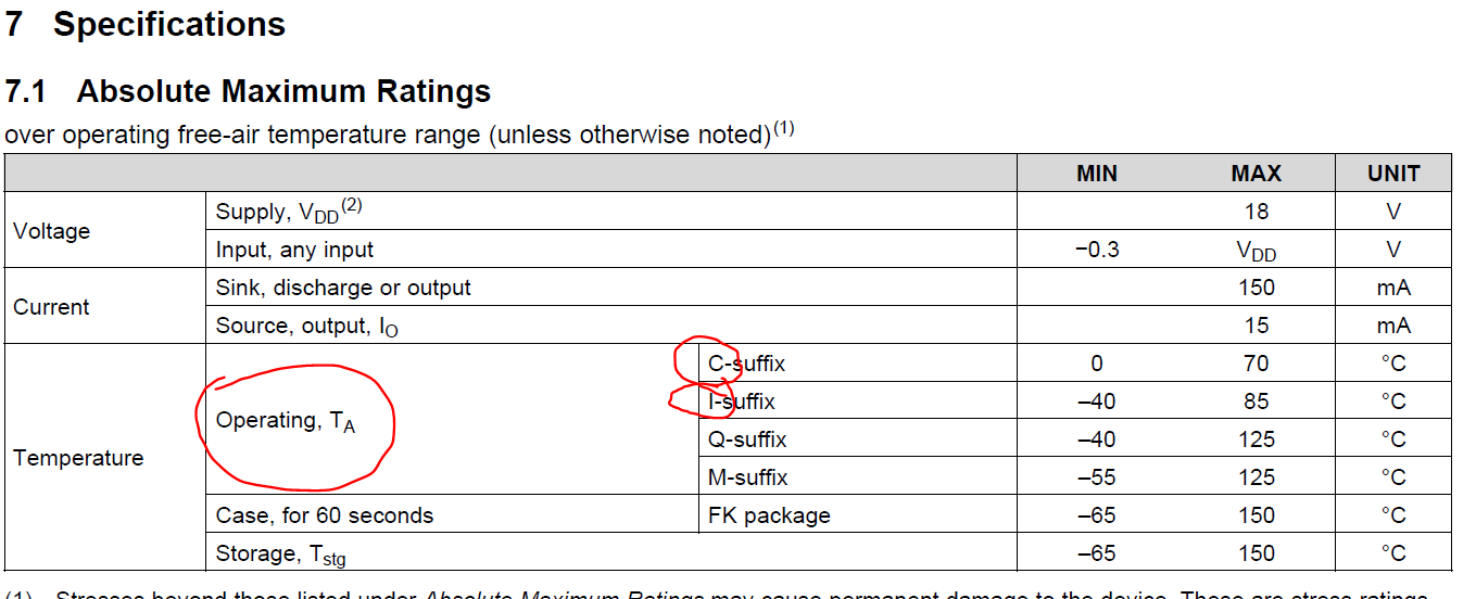

We are looking for Tj max for TLC555 for both C-suffix and I-suffix. The information will be used for system level thermal simulation.
Unfortunately we could not find Tj max in TLC555 datasheet. Will you help provide the info ?
