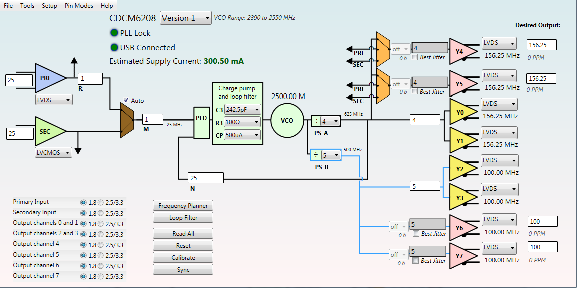

    I need Four 156.25MHz and Four 100MHz clocks, and I have planned output as indicated in below image.
    The EVM tool mentions that output is 0 PPM.  But could you please explain is there any relation between ppm and output jitter ?
    madhu
  • Hi Madhu,
    I recommend the below frequency plan- it is possible in this case to set all the fractional dividers to integer mode. This way the CDCM6208 should easily meet all the K2H jitter requirements.
    The PPM has no relation to output jitter- it is simply an indicator of how much frequency error there is. For some frequencies, the resolution of the fractional output divider is not great enough to generate the exact output frequency you want, so it gets as close to it as possible and the error is displayed in PPM.
    -Tim
